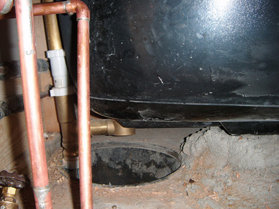

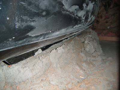

    Hi All, I am new and have found a lot of your posts helpful. I am at the tailend of a bathroom remodel. I purchased a drop in bathtub (acrylic) and the GC installed the tub, and assured me this is proper installation. It is sitting on about 5" of cement. When I stand in it, it crunches and crunches. Something tells me that is not good. Previously I had a jacuzzi tub that was in this tub's place, and it had the apron front. It was cemented to the floor as well, but only about 1-2" and never made noises. Here's a pic of how the GC has my tub installed. Thanks in advance!

    21,376
    Are those Sharkbite fittings? If so, I wonder about his credentials as a plumber! There is no good way to keep things aligned or anchored well when using those since they can rotate - they rely on an o-ring and teeth to hold things together, neither of which will keep things from turning if you put a little force on it. Plus, they cost 10-15x more than a good soldered connection.
    As to the bedding of the tub...I can't fathom a good reason to have 5" of the stuff underneath. It is a good way to do things, as if done properly, it will fully support the somewhat flexible tub and make it feel more substantial, but more is not better. If he actually used concrete, that would likely flow and leave voids. If he placed it there, then after it set, put the tub down, it isn't embedded.
    I'm not impressed. See what the pros have to say...

    jadnashua is correct, and you should listen to him.
    As far as the concrete under the tub...you are supposed to use mortar, not concrete! If done correctly, when you stand in the tub, it should feel solid like cast iron, and you definitely should not feel any flexing or sounds.

    Thank you Lurker!! Your comments have been a great help! I had a similar jacuzzi tub that was removed, and I believe it was mortared down, we never had problems with sound. But it was only 1 inch evenly spread....
    I told my GC today what you said...that they were supposed to use mortar....his response: "mortar and concrete are the same thing" ............................

    Simple answer. Concrete has stone in the mix' mortar doesn't. Any GC should know that.

    As for the tub... there is no reason to install with 5" beneath floor ant bottom of tub. If it must be installed with space 1"-2" is enough. I prefer setting directly on the floor when possible. Why raise, then support. The floor alone is sufficient support. Also if tub must be "mudded in" i drape a plastic sheathing over the mortar first, then set tub. This eases removal later if need be. Either way it keeps the properties of the concrete, mortar etc. from drying out i.e. cracking the tub in the future.

    Another thing with 5" of concrete under the tub is that it creates a safety hazard. Most people are not used to that big of a step getting out of the tub.
