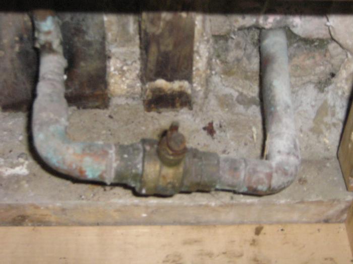

    Iím fussing with what to do with the main shutoff valve at my daughterís house. I want to do some work in her laundry area and so I need to shutoff the water while Iím working. The problem is that the handle on the main shutoff is broken, but my daughter says that the valve itself is functional, because she said she managed to close it relatively recently by using a wrench on it in lieu of itís original working handle.
    Iím attaching 3 photos. Unfortunately the quality of the shots is poor, but Iím hoping someone might still be able to recognize the valve. I havenít spotted anything like it at Home Depot to understand how it operates and most importantly see how the handle attaches.
    Does anyone recognize the valve? Do you think I can locate a replacement handle and simply replace it?
    Assuming Iím gentle, will trying to remove the handle likely result in me damaging the actual valve?
    If simply replacing the handle is a reasonable possibility, am I correct in thinking that I donít need to have the city shut the water at the street, just to replace the handle?

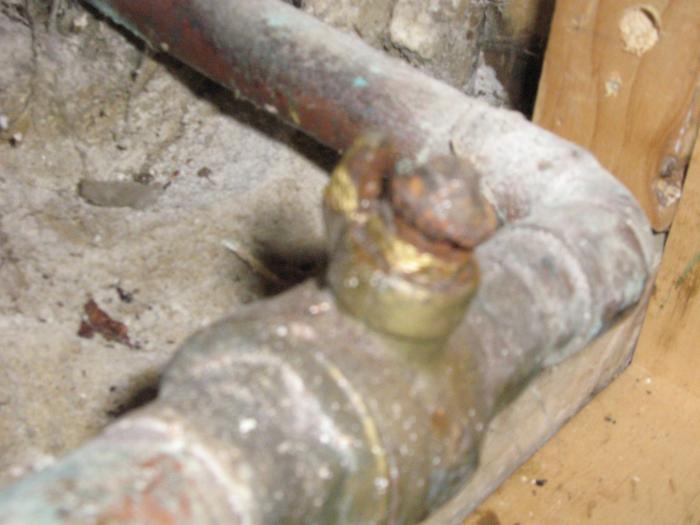

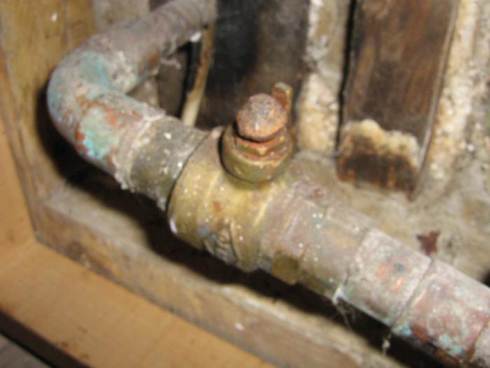

    Because the photos are poor, it seems to me like there are 3 distinct pieces at the top of the valve
    1) a circular ring that has a stub of metal sticking up from it (... maybe whatís left of the old handle? ... maybe part of the actual valve casting?)
    2) a 6 sided nut
    3) then finally some sort of top piece that I canít decide what it is/does (... is it another nut?)
    Any thoughts would be very much appreciated. Thanks.Name:  IMG_0852.jpg
Size:  35.2 KBName:  IMG_0851.jpg
Size:  40.3 KBName:  IMG_0850.jpg

    First thing you should do is look aroung and see if you can find the original handle, it looks like someone took it off for some reason.
    >>>Assuming I’m gentle, will trying to remove the handle likely result in me damaging the actual valve?<<<
    I don't think so.
    >>>If simply replacing the handle is a reasonable possibility, am I correct in thinking that I don’t need to have the city shut the water at the street, just to replace the handle?<<<
    Yes
    >>>1) a circular ring that has a stub of metal sticking up from it (... maybe what’s left of the old handle? ... maybe part of the actual valve casting?)<<<
    That is the handle stop to keep it from going round and round
    >>>2) a 6 sided nut<<<
    Thats what held the handle on
    >>>3) then finally some sort of top piece that I can’t decide what it is/does (... is it another nut?)<<<
    Could be, it look like your valve has two nuts, a lot only have one
    What you have to do is take the top nut off, you will need to hold back on the handle stop and use two pair of pliers, that nut should be a self locker so it will take a little effort to get it loose, the handle stop will then come off, do not lose either piece.
    Once you get them off you should see a threaded shaft comming out of the valve, it will not be round, it will be more like an elongated rectangle, if you turn that shft crossways to the pipe the valve will be off, if you turn it longways the valve will be open.
    I'm enclosing a picture of a handle, you should be able to see the shape of the hole.
    Finding a handle that fits that valve may be a prob. you may have to buy a valve just to get the handle (they are not all the same)
    P.S after looking at you pictures again DO NOT TOUCH THE LOWER NUT ON THE VALVE, THATS A PACKING NUT!!

    Hey Shacko ... you've given me exactly the kind of info that I was hoping I'd get as a "diy-er". Now I can decide between the "risk" that's involved with me trying to do it myself ... or just using a pair or pliers a second time, interim to replacing the valve that obviously has seen better days.
    Thanks very much!

    If you do what I recommended you shouldn't have a prob., once you get the upper nut off it will be clear, you sholdn't have to replace the valve, even without the handle you can always turn the water on or off with an adjustible wrench

    Did you look for the handle? it's common practice for someone to take them off if there is any kind of interference, they usually leave them near the valve.

    There's no evidence of the original lever style handle. I can't imagine what might have made someone want to take it off, at some point in distant history. It is in a spot where in might have intruded more into the actual living space when it was "open", but I'd still question the reasoning of someone that would want to defeat the purpose of a main shutoff valve ... but that appears to be what's happened. As I said previously ... thanks very much for your thoughts! I now know what I'm dealing with.

    IF you can find a handle for that size Ohio valve, AND the handle nut will come off the valve, then you can just put the new handle on. BUT, one problem may be unscrewing that corroded nut, since there is nothing to prevent the valve's ball from turning when you try to remove the nut, and there is no way to hold the "bolt" while trying to remove the nut. A "nut buster" would remove the nut, if you have one, and then "any handle" that had the right size and shape hole in it could be used.
