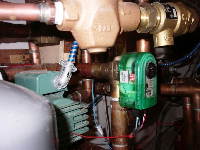

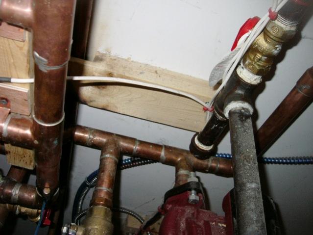

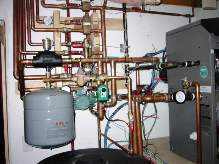

    I have added a few pictures. Sorry if the system looks a bit cluttered but I didn't have a very big area to work with. P1020447 shows the overall system. Boiler output is on right by pressure release valve, goes back to wall ( where it T's with one side returning to red Grundfoss system circulator on right and other leg of T goes left), emerging as the slanted pipe on left which rises to the Airscoop. Past Airscoop you hit the T's for the Mixing valve Input first and return second. At bottom of Mixing valve the T connect the returning water from the radiant zones into the mixing valve and also into the main boiler loop. The main boiler loop continues to the right (after the initial two T's for the mixing valve, turns back towards the wall and drops down to enter the red grundfoss system circulator. The tempered output from the mixing valve goes back towards the wall, loops around and goes into the suction port of the green TAco circulator, whose output port goes to the radiant floor zone valve manifold and out to the rooms. P1020446 zooms in a bit on the Mixing valve to show the tempered output. the blue wire is the tempered water sensor input to the mixing valve, and is located on the pipe right after the taco radiant floor circulator as it enters the zone valve manifold. P1020441 shows the detail of the boiler circulators output and return connection T's. Pipe in center is from poiler output. The left side of its T goes to the Airscoop. The right side goes to the Grundfoss system circulator. The right side of the Grundfoss "T" is the returning water from the zones and the main external boiler loop.
    Sorry for the wordi-ness of this but everything is rather cramped and I thought that without some explanations the pictures might be more confusing than helpful. Referring back to my original system diagram along with these pictures and my explanation of them may help to understand what I've done.
    PS: yes the vertical ball valve in center of P1020447 goes nowhere... that will be part of the basement's conventional baseboard heat when I finally get to it.
