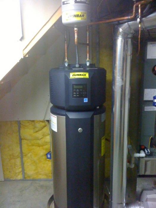

Dunbar Plumbing
2,920
10
www.KoldBreeze.com
I installed one of these back in July and the customer I did this for was very technical.​
He said that in order for his savings to be had,​
He has to keep it 12 years in order for it to pay for itself. Roughly $2200.00 installed was the investment.​
The warranty is only 10 years on this unit.​
He has chronic hard water, and buildup in this tank is guaranteed.​
I couldn't even get him to drain the old one initially and I'm curious to know if he'll drain this new one once a year to keep it operating properly.​
It is very quiet, no louder than a high efficiency furnace.​
I for one understand the condition of a 10 year electric water heater in a hard water region. No way will the efficiency of that heater stay even within the first 6 months of use over 10 years, let alone 12. !!!​
Lots of parts to fail, including the electronics to this unit over the life of the unit.​
If he calls when it malfunctions, I won't be the one to work on it. It'll be an authorized rep that narrows the playing field and raises the price to the final cost.​
Would I as a plumber promote this unit?​
Most likely not, knowing that you "have" to maintain this unit...which is draining it once a year, replacing the anode rod every 3 years would be smart, and not having any control over water conditions will affect it.​
If this system is used heavily, of course there's a greater chance for repairs in the future...and do you really want to spend $$$ amount of dollars to keep what will be outdated technology when the time comes, and it won't be efficient.​
You could get "possibly" better efficiency by replacing a cheaper tank heater every 3 years, knowing it isn't aged and costing you more than the energy guide dictates.​
Jury will be out on this...don't think you'll have fistfuls of cash after paying your electric bill each month. Especially when it took a personal loan just to buy it...5 times the price of a regularly priced electric water heater. Yikes.
