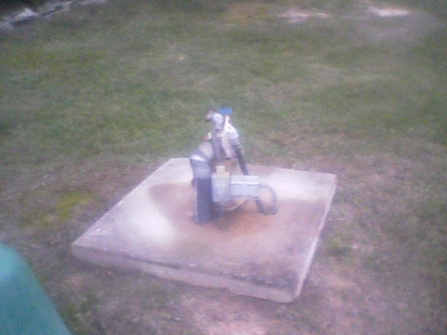

The pH is 7.1 How is the best way to tell what kind on pump and size? I don't see the pump when I remove the well cover.

Look for the pump controller, gray box with wires going and coming from it. There should be a label on it that says what size the pump is.

I don't see a control panel. attached is a picture.
