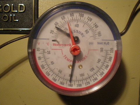

    Your boiler typically has a pressure gauge...what does it read? If you have an auto-fill valve, it could be shot, raising the boiler's water pressure. Or, as Redwood indicated, the WH tank could have a leak between the potable water and the boiler water, which would raise the pressure on the boiler, and cause its T&P valve to release (the SuperStor is a good tank, and unlikely but anything is possible - plus, the pressure relief setting on the boiler is a lot lower than the one on the WH). You probably have a valve before the autofill valve...you could shut that off to see if the water stops flowing.

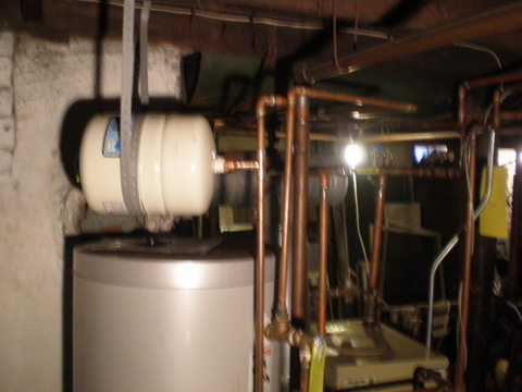

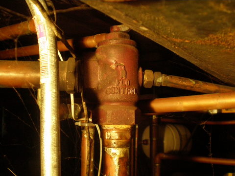

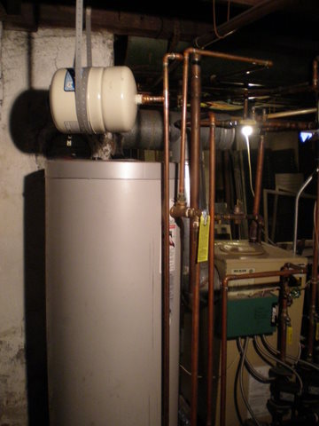

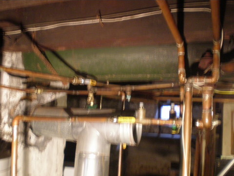

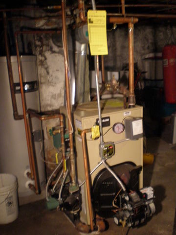

    Maybe a picture or a diagram of the layout would help. Way back at the beginning, when working properly, it was indicated that a T&P valve can release under any one of two conditions: excessive pressure, or excessive temperature. There is a manual release valve, and if the valve has corrosion or mineral buildups, if it does get opened, it might not close. So, the conditions that caused it to start leaking may have been resolved, but the valve may be bad, and the valve should be replaced.
    We're getting some conflicting info, so it's hard to evaluate exactly what is going wrong.
    DIY Member McG's Avatar
    Sep 2007
    CT, RI
    33
    Default Reply to Jim and Red with pictures.
    If you do not have a check valve or PRV on the incoming potable water supply, you do NOT need an expansion tank connected to it to account for the WH creating the hot, expanded water. I DO NOT HAVE A CHECK VALVE OR PRV ON THE INCOMING POTABLE WATER SUPPLY
    So, which T&P valve is releasing water? THE SUPERSTORE T&P. Water Heater.
    Your boiler typically has a pressure gauge...what does it read? See picture below
    Any boiler should have an air extraction device. See picture below There are various kinds, and some work better than others. Verify what you have, if you have one, is working and not gunked up. I like Spirovents, but there are others.

    I am slowly beginning to know my way around this system but it is all new to me. The air purge mechanism appears to be missing from the boiler. Unless the "flow control" is for air purging... it is inline with the green boiler expansion tank mounted between the joists.

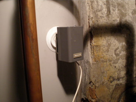

    And here is the boiler gauge...
    Sep 2007
    CT, RI
    33
    ...and the "flo control"...which does I don't know what
