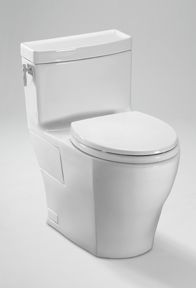

    Hi Terry,
    I need your help! I have been reading up on the Toto toilets, but not all info is current. I was decided on the Soiree model MS 964214CFG when I discovered the new Aimes! but I can't find anyone selling it, or even what the retail price is. We have well water/septic system, so I prefer the 1.6 GPF & realize the Aimes is 1.28, but wow is it nice looking! Do you have any info/advice for me? Selfishly, I prefer the best flush since we're not paying for our water. Thanks in advance.

    The Aimes apparently is a new model. I could not find much data on it when I Googled. One source I skimmed over indicated it was just introduced this month. It will be interesting to find out more information on this model. Terry probably has more accurate information than this, so stay tuned. As far as the 1.6 vs the 1.28, reports on this forum indicate the 1.28 work just fine, so I would not let that be a deciding factor in my selection.

    Default Aimes® One-Piece High-Efficiency Toilet, 1.28GPF, with SanaGloss
Size:  65.2 KBhttp://www.totousa.com/ProductDetail/tabid/75/Default.aspx?ProductId=28f2a6da-3051-4319-8e66-aeb051345238&SearchId=3dbe2137-eba0-43a8-b9e3-608d7d65ac2c
    $920 retail Cotton White
    $679.99 would be my price in Seattle.
    The Soiree has been working fine at 1.28, so this should too.

    The Aimes is really nice. Modern and classic at the same time. I was going to get the Carlyle, then I just saw the Aimes on the Toto website. I was wondering why I hadn't seen it before. Unfortunately, it is so new I can't find it anywhere yet. Hopefully it doesn't turn out to be too much more expensive than the Carlyle.

    before I placed my order for the new Aimes toilet, I checked the installation instructions. They appear to me the same instructions as for the other one piece skirted toilets. My question is how critical is the requirement for the position of the supply. the instructions say that it should be 8 - 10 inches to the left of the flange center line. I, of course, have a supply that is spaced 5 inches from the center line. With the Aimes, how much of the problem is this? The bottom rear profile of the Aimes (from a side view) seems to be further away for the wall than some of the other 1 piece skirted toilets. Does this make the supply spacing less of an issue, particularly is the supply is fairly close to the wall -- my supply comes off the valve at about 2.125 inches from the wall, and the end of the valve handle is about 3 inches from the wall. I can't tell from the pictures and my local Toto dealer doesn't have the Aimes on display (sales guy didn't even know about it). If I have to move the supply, I'll probably have to get a different toilet. It would be a PITA to move and cost $400 for a plumber to do it (significantly increasing the cost of the toilet swap).
    I hope some one can shed some light on this. Thanks.
    14,202
    It looks like a shutoff at 3" to the left of center would work.

    Great. So I can assume that my shutoff at 5" to the left of center (and 5" high) should work.

    It should be fine, but I'd suggest installing a new 1/4 turn shut off valve while you are at it.
