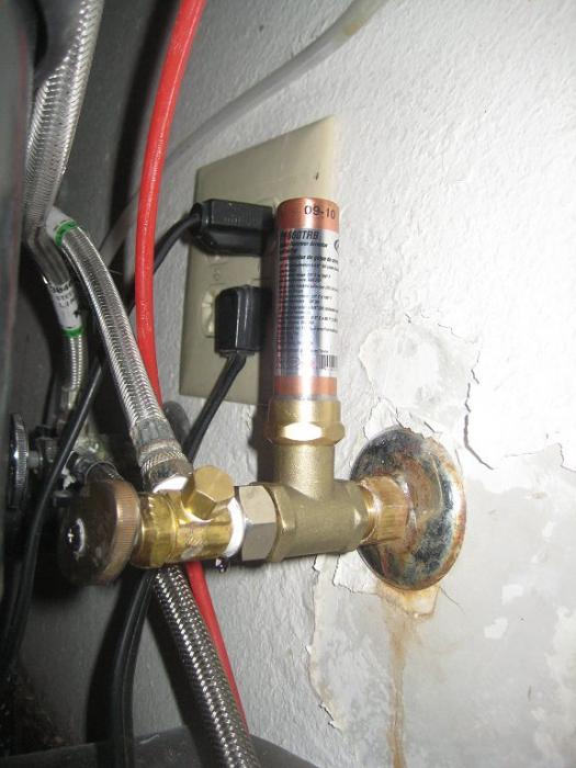

    This did not happen prior to our bathroom remodel. Only after our bathroom was redone did the pipes start banging when the cold was on full blast, but this only happened at the kitchen sink. The banging did not happen when you turned the water off. It was when the cold water at the kitchen sink was on full blast that it happened. The remodeled bathroom is on the second floor, not above the kitchen, and if you turned the cold on full blast at the kitchen sink, the pipes in the kitchen started banging really badly.

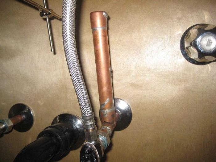

    So we got in touch with the contractor who redid the bathroom, and his plumber did not know why the banging was happening. He tried to remove air from the pipes but that did not solve the problem. Next he installed a vertical piece of pipe in the upstairs bathroom under the sink (picture one attached) but this also did not solve the problem. Now tonight he installed a different type of vertical piece of pipe in the kitchen under the sink (picture two) and this seems to have stopped the horrendous banging.
    It seems that these vertical pipe pieces (on the cold lines only) are a patch to the problem, which was not a problem before the bathroom remodel. Our plumber seems to want to blame our new Jado valve, saying that it causes too much pressure in the lines. We want to know why this banging happened in the first place (only the cold full blast in the kitchen) and whether these vertical pipe pieces make any sense. We do not want to have to drain the lines periodically so this alleged patch job continues to work.
    PSI is 65. Thoughts please? Thanks in advance.

    The first chunk of copper is useless, the second is a proper water hammer arrestor.
    What happens if you regulate the pressure down to 50psi instead of 65?

    19,402
    A hammer arrester is an engineered device with a sealed air chamber (a piston or bladder - yours has a piston separating the air and water). It works until it fails, and that should take many, many years. The first one is an old school air chamber...open to the water, and very quickly all that air will disolve into the water stream as it passes, and be useless. Shutting and draining the lines usually won't restore the air (think finger over the top of a straw). SO, shortly, it will be come useless. It could stay, but it isn't doing anything.
    Water hammer is caused by moving water stopping rapidly, causing the pipe to continue to move via inertia until it hits something, like a hammer, and you hear the noise. A constant vibration is usually caused by either some debris bouncing in the pipe against something that is then restricting the flow, and the pipe then vibrates. As noted, if there is a valve with a loose washer, that washer can vibrate as water passes, changing the water flow, similar to some debris. You may have to remove the aereators from the faucets, maybe the cartridges, and the toilet fill valve then turn the water on to see if you can dislodge any debris.
    Make sure all shutoffs are fully opened, and if not 1/4-turn ball valves, you might want to consider changing them to that type (1/4-turn valves don't have traditional washers and have less restriction).

    23,717
    The real problem that what you describe is NOT conventional water hammer which occurs ONLY when a faucet or valve is closed suddenly. It does not happen while water is flowing, so we cannot tell what the cause was, or why the arrestor "cured" it.
    DIY Junior Member VernK's Avatar
    Oct 2010
    Kelowna, BC
    The arrestor, in this case, added a "spring" to the system and maybe luck just had it that it was just the right rate to damp the vibration
