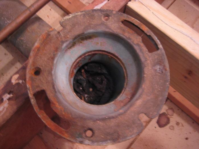

    I have an intermediate level of DIY skill, although more in the automotive and small engine repair than in plumbing. Here's the situation.
    I had water damage around a toilet and removed the toilet to replace the floor (2 layers of flooring)
    I thought I could keep the flange, as it is in good shape and slide the two layers of flooring tight up under it (with 1/2 circle cuts around the waste pipe) However, the toilet was right next to the tub and I could only angle the first layer of sub floor under the flange. I can't angle the top layer of flooring enough to get it up under the flange.
    So, now I would like to remove (and reuse if possible but not critical) the flange. With the flange out, I'll cut new flooring at the same level as previous flooring. I'll cut a circular hole for the waste pipe, secure the floor, and replace or re-use the flange.

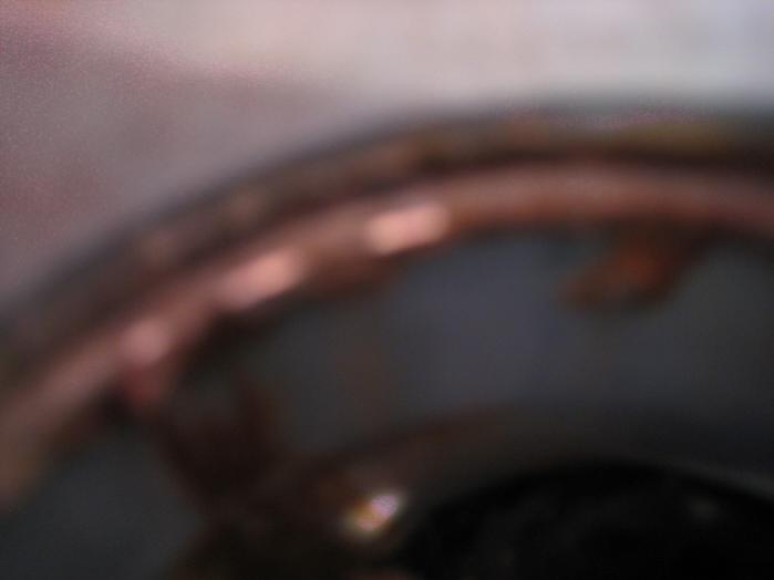

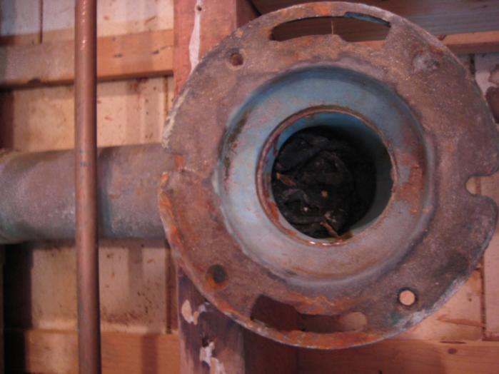

    I have attached a few pictures (although they aren't good quality since I had to re-size them) and need to know how to loosen the flange. Picture 3 is of the outer joint and picture 4 is of the inner joint. The flange seems to be the same material as the waste pipe but I tried loosening it with a cold chisel and a ball peen hammer, then with a bigger chisel and a sledge and it didn't move a bit. It looks like there are seams (joints) on both the inside of the wastepipe and the outside of the pipe.
    Can anyone help with the type of material it is made of and the best way to loosen and remove the flange without damaging the pipe itself?
    Thanks

    It looks like copper to me. It would require heating the joint to remove the flange. Then soldering the flange back on. The joint can be heated from inside the pipe. After the flange is installed be sure to screw it down to the floor.

    If it is NOT plastic, what kind of pipe is it because each one has a different method of repairing it. Give us a picture of more of the pipe, especially the joint where it connects to the tee. What you took pictures of were "teasers" without giving us any real information.

    Default Copper Joints
    That looks like a piece of 3in copper that has been packed into a 4in cast iron flange.
    I WOULD NOT TRY TO UNSOLDER THAT JOINT, THERE'S A GOOD CHANCE THAT YOU WLL MELT THE ONE UNDERNEATH.
    To get the flange off what you have to do is, put a rag down the pipe (so you don't drop any thing down there), take a drill and drill a lot of holes in the lead thats between the pipe and the flange, then take a chisel or screwdriver and pry the leak out, once you have it moving it should come right out, under the lead is oakum, do not drill in that (it will just wind up on your bit), when you have the flange loose it should just come off.
    From your picture it looks like the pipe comming into the flange is real short, you wont be able to use an adaptor flange, you'll need to pack your flange back on, I think you will need a plumber to do that, sorry.
