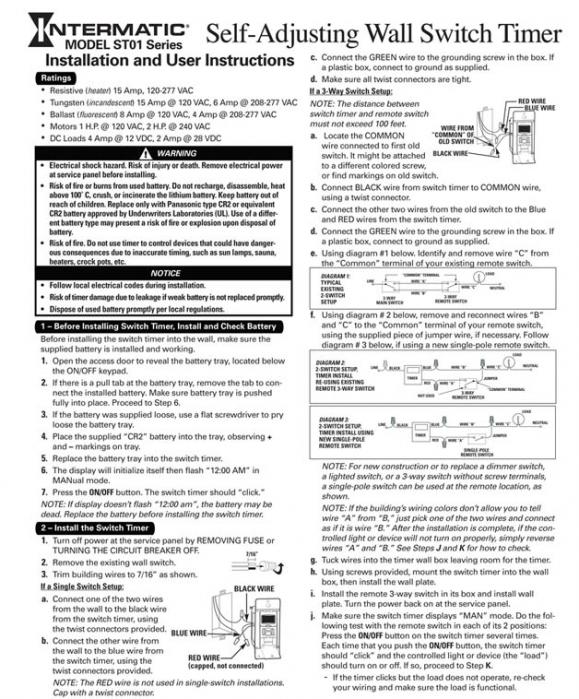

    I have a 3 switch plate on my wall. One switch is for an indoor light switch ( 3 wire, as there are 2 on the same line). The other 2 switches are two separate outdoor light fixtures. I would like to install an in-wall timer that controls both outdoor light sets at the same time. Is this possible?

    Thanks for the responses. Here's my plan in my layman's terms. In the wall are 2 switches, each attached to 2 black wires and a ground. The timer does not require a neutral, although it has a red wire for use in 3 way setups. My plan is to attach one black wire from each switch to one black wire each on the timer.
    This leaves 2 questions. 1) For the unused red wire from the timer, can I just cut the wire, or cap it with a wirenut, or both? 2) For the 2 ground wires, can I just connect them and cap with a wire nut, or do I- connect the 2 ground and run a pigtail to the grounding screw on the timer, or connect the 2 grounds, and use a green wire connector with the hook from one ground going to the screw on the timer?
    As you can easily see, this is new to me. Thanks for your help in advance.

    Post a link to your timer.
    If your timer controls an internal DPST electromechanical relay then it should be easy. Otherwise you should confirm where each black wire from each wall box goes: to a 120 V source, to a neutral, through a load to a 120 V source or to a neutral, or to somewhere else. Measure with respect to a known good ground or neutral or hot lead while using an incand. lamp across your voltmeter leads.
    Also check if there is 240 V between any two black wires, without using the the lamp.
    If you hook it up anyway without knowing, because of the permutations and combinations possible with hooking up four wires, the odds are overwhelming that it will not work and/or you will clobber the timer.

    It's this model timer.
    http://www.intermatic.com/products/t...ers/st01c.aspx
    I've also attached the installation portion of the instructions.
    Homeowner Thatguy's Avatar
    Aug 2008
    MD
    1,460
    If a separate breaker controls each switch you can't use this timer.
