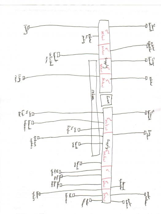

That says the problem is in the supply an 8x20 duct at 1600 cfm for 4 tons of cooling is .25 static which is o.k but leads me to believe it's the taps off of the supply. how many runs come off & what size are they?

Based on what you said 1600 CFM and 25 six inch vents the six inch ducts are fine.
(~64CFM thru a 6" duct is sufficient, assuming you unit is OK, it is your supply and return size.)
Note: the mention of .25 SP is .25" per hundred feet of 20"x8" straight duct. This does not count the grill pressure drop, filter loss, elbows,transitions, 6" duct, plus the similar losses for the return system. I doubt if your unit puts out 1600CFM at a .75" external SP but something less.

so what size duct would you reccomend for the supply and the return? or do you need a drawing of what my setup looks like

Need a plan view rough sketch of the trunk lines and the approximate location of each of the 6" duct in reference to each other and approximate length in feet between the 6" ducts totaling the 48' of trunk line. (Some of the 6" ducts may be acrossed from each other or off set.)
You still have my email if it would be easier. I can accept pdf older versions of autocad or smartsketch.

I emailed the sketch to you and I will also post it here, it might be too big a file to upload but I'll try. thanks again!!

25 supplys at 6" apiece adds up to (28" x 25= 700 inches of air. But the main is only 8x20= 160 inches. That means the MAIN DUCT is much TOO SMALL to handle this amount of supply takeoffs.
You need a pro to come in and size the supply AND return properly.

Yes ,Gator37 has given good advice. it's the same advice given by me and some others .
Your MAIN TRUNK duct is either not large enough to supply those 25 6" takeoffs.
Or it also could be that those 6" takeoffs are not required. Pehaps 4" or 5" would be sufficient to supply these rooms.. i have been in Hvac for almost 50 yearsand I know what i'm talking about.
Get a real pro to come in and look it over. this time call in an hvac rep, not any old plumber/carpenter or butcher, but a real live hvac (heating/ cooling)pro, not a "supposed" pro.

Again, if I could find a real pro I wouldnt be here. The first one was the guy who put the system in, and the other 3 I found out of the phone book, all local guys too. You act like Im looking through the newspaper or I'm just calling anyone who thinks they can do hvac work, Im calling straight out of the phonebook. Isnt that people normally do, use the phone book?? I got more info from emailing gator37 than here is what I was trying to say. I know the 6" ducts arent the problem because I have shorter runs that are also 6" and they still dont get enough pressure, so it has to be the supply duct and or the return duct
