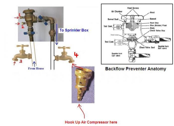

I have a small dilemma and I am wondering if I am going to need to call in a plumber.
I am planning to blowout my sprinklers at the end of the season on my own and I thought I would do a little research to make sure I am doing it right. Through the various blogs and the how-tos I have discovered that you must not blow out your sprinklers through the backflow preventer because it will melt the rubber gaskets. This makes complete sense, however, when I refer to the setup I have at home I have found that the hose bib (where I have planned to connect my air hose) is before the backflow device which essentially means that I will be blowing air up through the backflow and down the line to the sprinklers. On top of that I will be forcing air down the main waterline, although closed inside the house, it is still a concern that the constant air might do some damage.
So my question is... am I OK to blowout my sprinklers as is or am I going to need to call in a plumber to remove the hose bib and move it so it is after the backflow device? :confused:

Don't worry about the PVB, it can take a lot more than you think. If you have an RPZ (not common in MN for residences) I would blow after it. Your inside pipes can take a lot as well. Just regulate your compressor output to blow out the sprinklers with slightly more pressure than normal water pressure. Be sure to drain back to the main shut off. Go thru the zones at least twice, open and close the little check ports as well while blowing and be done with it. I usually close both ball valves on the PVB when done. If your inside shut-off valve is a gate type valve, be sure to get it shut off tight. They have a tendency to leak after a few years. If you are not sure of the valve's condition ,leave the drain open and hang a bucket under it thru the winter.

UPDATE:
I just installed a hose bib just downstream of the Backflow Preventer, see #4 in the picture.
This hose bib is used strictly for Sprinkler Winterization.
Actually this port (#4) is the recommended port for blowout procedure, although the reality is different as 99% of the homes out there do not have this port, read on.
Couple of notes for those who are new to this Sprinkler Winterization procedures.
1. When you hire a Company to winterize your Sprinkler system, and since 99% of the homes out there do not have port #4, they blow air through ports #1 or #2, not a recommended port but since they use low pressure (less than 80 psi and has high volume tank), the risk to the Float Disk is low.
2. If you decide to do this at home using shop air compressor (the standard 2-3 gallon type), there is a way to do this:
a. If you don't have port #4 and want to blow through port #3, it is tricky because once air pressure is below 20-30 psi, the Float Disk drops down as there is no water and the pressure is low.
Remember the Float Disk needs water to float!
- Once the Float Disk is down, it is virtually impossible to blow it back up using air!
- To over come this issue:
---> I remove the Float Disk
---> Use a small spring (Home Depot) below the Float Disk, and re-install the Float Disk to keep it tight against the housing so there is no air leak.
---> Now you can winterize the system.
---> Just remember to remove the Spring later.
However option b) below is better:
b. This weekend, I just installed a hose bib just downstream of the Backflow Preventer, see #4.
It is very easy with a Propane Torch and about 1 hour.
If you have done plumbing before then it is easy.
Otherwise get a plumber to install this for you.
Now I winterize via this hose bib in port #4.

The procedure outline very well by cn90 may be absolutely correct for the BFP he uses and that is shown. However, this is not the only type of BFP device used. My BFP is a Wilkins 950 double check and has a much different configuration than the one show here. To my way of thinking, installing a second union and making the BFP removable and putting it in warm storage for the winter makes drying it unnecessary and would be just as easy as installing the hose bib. This would work for any type of BFP. Certainly do whatever you are comfortable with.

New house, first sprinkler system. Prefer to winterize my own, and here is a picture of my setup. Thinking I can blowout of #3 with an adapter replacing the drain.
If not, I think i have to put something new around 4. I partially think a union so I can remove the backflow preventer, but around here it seems like people just leave them on this winter (just outside boston). Or do a hose bib like the diagram from the guy before me.
Anyone know if #3 is ok? It is past the backflow preventer, so I would think it would be the easiest.

From 3 to 1 will be easy to drain. But I think you will need to find the other end of pipe 4 and open it up to get air to blow from 3 out to the inlet of pipe 4.

Sam, you're halfway there. the cap at the bottom you remove after shutting the water off inside the home. Open the two port on the BFP and water will drain out. On the pipe to the sprinklers, you need to add a spigot. This picture is from above. You need to add spigot #4.
