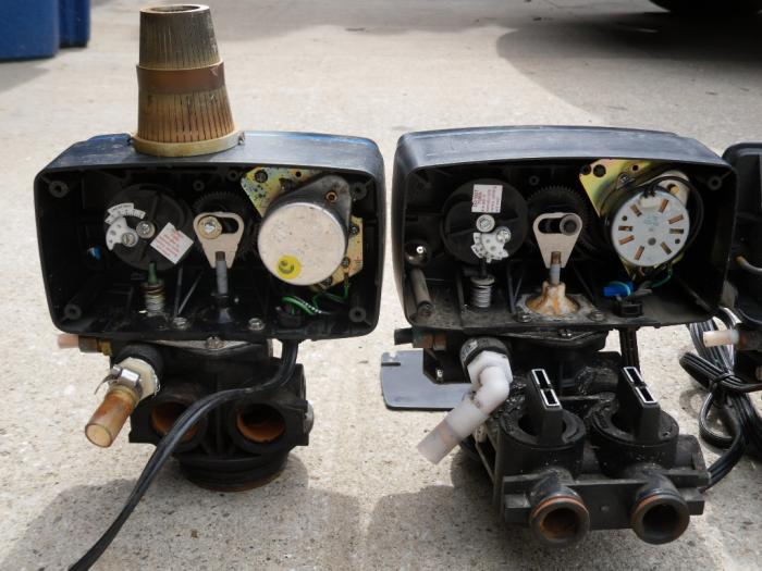

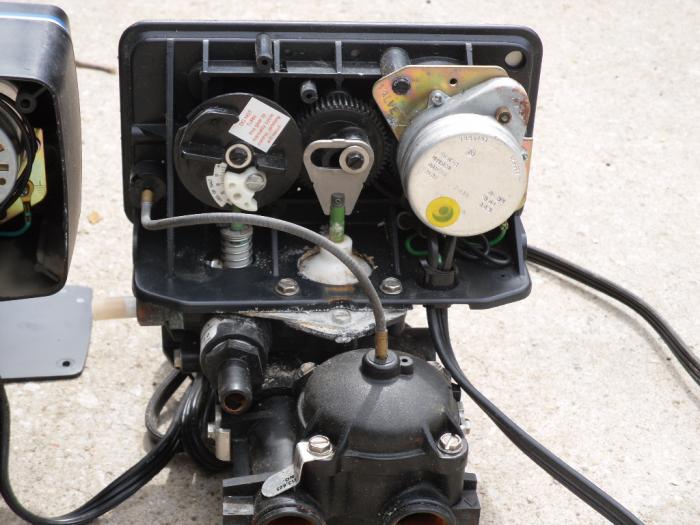

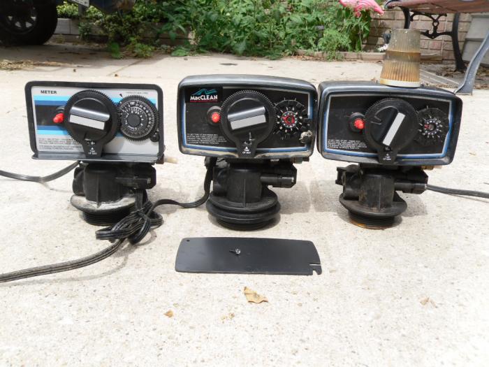

    I don't know how this works so here goes. I have a failed MacCleens iron filter that i need to replace. I also have aquired 3 old softners, one with a fleck 3210 and the other 2 with a fleck 3200. Rather than purchase a new filox media filter, can I use the parts from these and just purchase the new media and gravel, If so, what do I use for the control head,and what do i do with the brine settings, and inlet on the controller?

    Fleck 3210 and 3200? that would be what kind of timers are on the valves?
    Might there be a photo of the units in question?
    It might be that you could buy new media , but what media is a question ...
    But I be at a loss on the type of fleck valves that you have.

    The valves are 3200/ with manual skipper wheel, or 3210/ with water usage auto set wheel. I also have the original 2510 that is on the old MacCleens unit, that could be rebuilt?
    Do you need a picture of the valve body?

    Photos would be great... of both the valve body and timer controls on the front of the valve bodies.
    2510 is a valve that is in use today so that can be rebuilt with no challenge.
    You might wish to start a new thread for this,
    Some thing like Refit of Iron Filter
    Just a thought.
Size:  65.2 KBName:  SAM_0866.jpg
Size:  57.2 KBName:  SAM_0867.jpg
    these are valve and timers ihave
