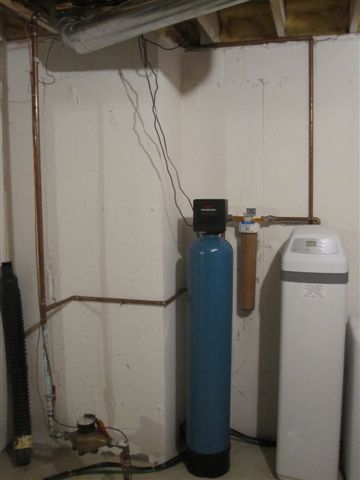

    Hello All,
    I have a recently rebedded/refurbished Birm Iron Filter which expells iron and sediment after the outdoor sprinklers are ran. We had the same problem prior to rebedding. The iron filter is NOT in-line w/ the sprinklers. I have a 50 psi community well feed to the house; the iron filter T's off the main line. The main line continues on and runs out to the sprinklers.
    Has anyone ever seen this? Do I need an inline check valve to the iron filter (which runs to a water softner and the rest of the house). I thought as long as I wasn't inline w/ the main line, I should be ok. After a regen cycle, there no more iron that is expelled. Is the iron filter somehow getting aggetated? We inherited the system when we bought the house.
    Thanks in advance!
    I think you're looking in the wrong direction. Unless you have a pressure tank after the softener, no water can go backwards through the filter, and if it did, it wouldn't cause rusty water like in that glass because the water from the filter is usually clear.
    I question how much water you are using for the sprinklers, and what the water quality coming to the house is after they get into watering for say a half hour or so. The filter looks like a 1.0 cuft or smaller so it isn't going to have much capacity to remove dirty water coming into it. Some/most would go right through it which is your problem.
    So no check valve is needed unless you have a pressure tank after the softener or something else that stores water with compressed air in it to power a back flow through the filter. And then I doubt you'd get rusty water through the filter to the faucets unless the water coming to the filter is rusty.
    Check your plumbing to make sure the filter is not plumbed backwards. And remove the cartridge filter after this filter and run the sprinklers and after say 30 minutes run water at a tub and watch the disposable cartridge housing for dirty water. If you get dirty water, then check the water going out the sprinklers and see if it is rusty. If it is you've found your problem; running too many gpm for too long causing the water to get rusty.

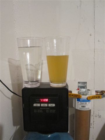

    Hi All,
    Great comments everyone. Here's a little more detail. The water on the left is what is coming into the house. The water on the right is what is coming out of the iron filter. The particulate filter in the middle is also clogged with a lot of iron. The water is a city community well servicing probably 250+ homes. It's treated by the city and they add phosphate to the water. I think it's about 2-2.5ppm iron. Here's the scenario which will cause this issue:
    1. Morning showers and water coming out of the iron filter and softner were clean and clear
    2. Left for work and turned the sprinklers on before I left
    3. While the sprinklers ran (11 zones), the house water was NOT used. It was not used for 8 hours thereafter.
    4. Came home and a big plume of iron came through the house. The inlet water to the house was what you see on the left and the outlet water was on the right.
    There is no pressure tank after the softner. I wouldn't doubt that when the sprinkler system is on, it demands high flowrates. I'm not a plumber or water softner expert, but wouldn't that drop my pressure possibly. If it drops to let's say 40psi when I run and my house is at 50psi plus, I could see that it could leak bakcwards a little until everything is equilibrium. Also, if maybe a sprinkler line outside is completely empty of water, wouldn't I get even a bigger pressure drop. So it's possible I may be getting a little oscillating effect too through the house plumbing as it switches zones.
    I do not see any inlet water coming into the house anywhere near to what is coming out (as you can see from the glasses). From all of your comments, I'm thinking I'm getting a little backflow.
    From all of your comments, I'm starting to subscribe to the theory that I need some type of isolation on this water circuit (check valve). If this is put in, do I need a hold or expansion tank (5 gallon or so), to act as a buffer so I don't pop my pressure valve on my water heater tank all the time.

    The rusty water is coming out of the iron filter...out of the softner...and out of the house. If I am getting a backflow, the source may even be the water softner, because the particulate filter in the middle is clogged with iron.

    Eleven zones, all at once.... you are using enough water to scrub the iron residue off the inside of the city plumbing causing rusty water to the sprinklers. You come home and turn on water and get too much dirty water for your undersized Birm filter to remove and get dirty water though it.
    But we'll go your way and you can explain how that works.
    Tell me how water flows backwards out of the house when it is a closed system that is under pressure with no pressure tank to force the water backwards.
    If that were happening, you would have to allow air into the house plumbing OR the negative pressure (vacuum) would suck the filter and softener tanks in like crushing a Styrofoam coffee cup. That hasn't happened.
    Also, to form a negative pressure (suction) in the house, you would have to have a venturi effect and your tee probably can't act as a venturi, especially when the house is pressurized which as long as there is city water (it is under pressure or the sprinklers don't get water). You must have pressure to cause flow to the sprinklers for your suction idea to work or the water won't be sucked out of the house right?
    So I suggest you start thinking of other more likely causes or... go spend some money for a check valve and take the time to install it and see what happens. My money is on that will not solve the problem.
    You can also ask Wally Hays here to explain how you can suck water out of the house.
