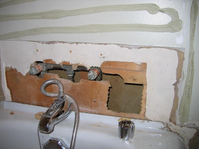

    Hello everyone!
    This is my first post, and I believe it may be a doozie!
    My wife and I just bought a 1930 house that has been completely renovated inside in 2007, however the plastic tub surround was not installed properly and there was quite a bit of splitting of the silicone where the tub surround meets the tub. I expected to find some wall damage, but did not expect to find what I did. Upon cutting into the drywall (which is just plain old drywall) to remove it, I discovered the original lath and plaster walls are still behind the drywall! We removed the drywall layer about 3 feet up from the tub until the wall felt dry, and the walls behind the drywall look and feel to be in good shape. We do not want to get into tearing all the lath and plaster down to the studs and starting over even though that is probably what you all will suggest. I think we will just re drywall the cut out spots with greenboard and reinstall a new plastic tub surround. However, here is the big question that I have. The tub is on an outside wall, and the person that did this put a vapor barrier between the old plaster and the new drywall only on the outside wall and this was also the wettest of the 3 walls. Should this vapor barrier be there, or should I remove it and screw the drywall right to the plaster like the other two inside walls? Could I then use a vapor barrier primer on the greenboard to seal everything before installing the tub surround just to insure no future water penetration?
    phew.. sorry this was so long, but I am at a loss and need help!

    I think you are asking for problems with the vapor barrier there. The surround is (at least in theory) waterproof, then you have another layer sandwiching the drywall. Anything that might have gotten in there had no way to dry out.
    Greenboard is no longer approved (at least in the national codes) for use in damp areas, primarily because it really doesn't work well. Yes, the paper covering is more water resistent than 'normal' drywall, but once you put all those fastener holes in it, it doesn't really buy you much of anything. There are some panels that are decent, though. Some surrounds are designed to attach to the studs, and no wall is required behind them. Verify which type you have.

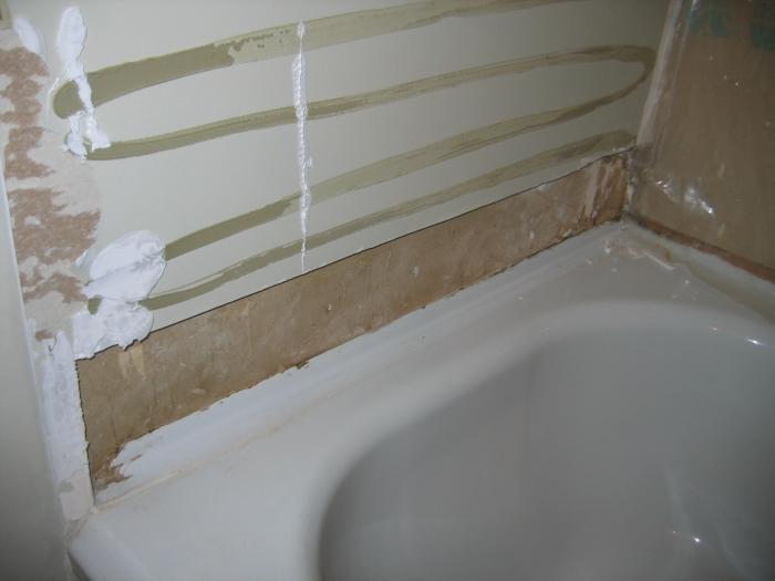

    The silicone on the old tub surround was pretty degraded where it meets the tub, so I am thinking that is how the drywall behind it got wet, but I cut out the entire first layer of the back wall about 3 feet up from the tub and it was all wet to the point that there was mold on the polly that was between the 2 layers. This seems excessive to me, and this is why I am worried that the vapor barrier was somehow trapping moisture between the drywall and the tub surround. I don't think I can put up the surround without replacing the layer I removed because the surround would either have to go inside where I cut out leaving a very ugly unfinished drywall edge, or overlapped onto the finished wall and then there would be no support where the half inch of drywall was removed.. I would love to insert couple of pictures I took if it would help you see what I mean, but I don't know how.. It asks me for a url when I try to insert.

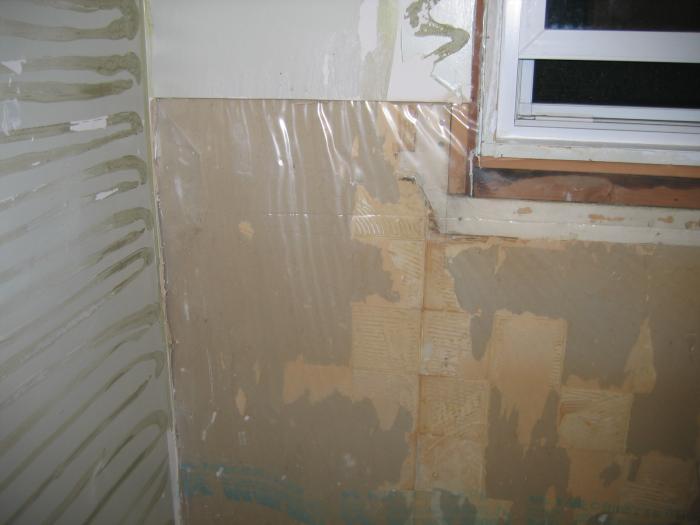

    thanks. here are some pics:
    DIY Junior Member lcann25's Avatar
    Sep 2010
    Saskatchewan
    10
    update:
    drilled a hole through the inside wall to see what was in there. from outside to inside looks like this:
    -exterior wall - wood shaving insulation -3/8" plywood - drywall - then the vapor barrior you can see in the picture, so on top of this will be the cement board.

    I have a similar tub layout.....with the window. I looked at the popular tub surrounds and could not see how I could cut the surround for the window and seal it properly. The one I wanted to use was the Accord tub and shower surround set....
    How do you plan on cutting out the surround and finishing it around the window so there is no leaks? The window makes no sense to me as to the location......I have 2 bathrooms like this and really wish the windows were not there......I would have been done as the surround is way faster and easier........

    rich, the old surround was cut to the window frame and then a nice wide trim moulding put around it overlapping the surround, then the moulding was painted with a high gloss paint and every seam siliconed. This seemed to work as there were no signs of leakage around the window at all (the stains on the wood below the window were obviously there from a long time ago because everything is dry around there now)
