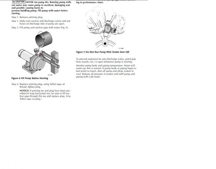

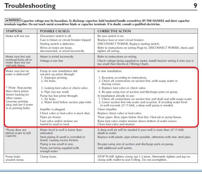

    Thanks for the reply scottallard,
    OK, I dont know if my pump is a booster pump or not. If this helps it is a Flotec FP5162. Here is a link to one here:
    http://tinyurl.com/39mghbx
    Anyway, I primed the pump by adding water to it and now the valves on the outside have water coming out when I turn them on, but the sprinklers still do not come on. I have uploaded a better video showing the outside pipes as well:
    http://www.youtube.com/watch?v=V1g6mP5YT68
    Also, I have added 2 screenshots from the pump manual which shows how to prime it and also the troubleshooting steps for my problem.
    Hope someone can give me some ideas as it appears "priming" it did not work
    Thanks for your time.
