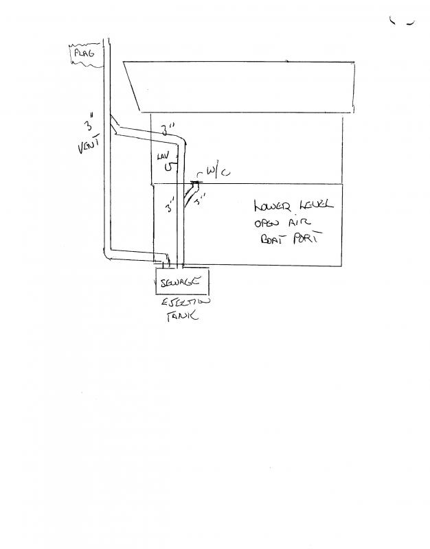

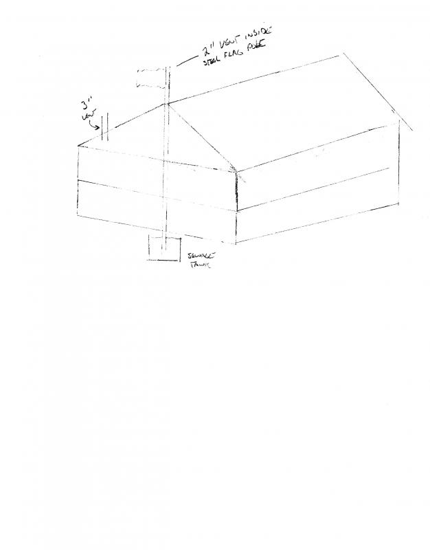

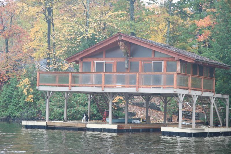

    Hello,
    I have constructed a floating boathouse in Ontario Canada. It is to have a small ,2 piece washroom in the cabin on top. (see pic). The lower part of the boathouse is completely open, much like a car port. There is to be a lav and wall mount toilet. The wall mount toilet was used so that there would be no plumbing visible from the lower deck. The waste stack travels down inside the center rear 6 x 6 steel tube column so 3 inch drain is not seen. The 3 inch waste stack continues down under the lower deck to the sewage ejection tank. From there the waste is pumped up to the septic tank on land. The problem is that the inspector insists that we need a 2 inch vent from the sewage tank travelling all the way back up inside the building and tied into the 3 inch stack exiting the roof. We cannot fit the 2 inch pipe inside the steel column now. We would have to leave the 2 inch vent exposed on the lower deck and run it up through the second floor. By code, could I run a separate 2 inch plastic abs vent inside a steel pipe, up the rear side of the building and carry on above the roof but not passing through the roof? I dont want to go through the roof and cedar shakes already installed. I would use this also as a flag pole , concealing the vent . any input is appreciated, thanks.

    if i read this correctly you want to run the separate 2" vent for sewage tank, through the wall and extend above roof line?
    if so it still need to increase in size to min. 3" pipe through the wall and remain 3" outside the building to its termination. basically any vent you run on the outside needs to be 3" min.

    Quote Originally Posted by mikeplummer View Post
    Thanks for the reply. Yes I want to run the 2 inch sewage tank vent line up on the outside of the building and extend it above the roof line but not through the roof overhang. It wouldn't be going through a wall as the sewage tank is already outside under the lower deck of the boathouse. The vent would be set off the building far enough to clear the overhang of the roof and would carry on up above the roof. Would this still be required to be 3 inch? I'll send an improved drawing if you like.

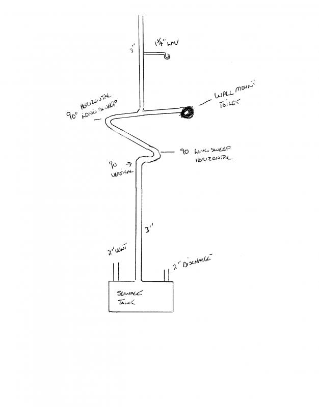

    I have another drawing for the lav and toilet in the boathouse. I understand that as soon as a vent leaves a building and goes into open air it must be 3 inch.Therefore as soon as the sewage tank vent exits from under the lower deck it has to switch to 3 inch as the whole lower level is an open air boat port. Can I run the 3 inch vent straight up outside building, terminating above roof and tie 3 inch vent from toilet and lav into this as shown in drawing? I would use a galvanized tube to run vent inside and attach to the outside of the building. Thanks for your advice.Name:  boathouse plumbing 3 001.jpg
