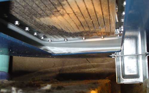

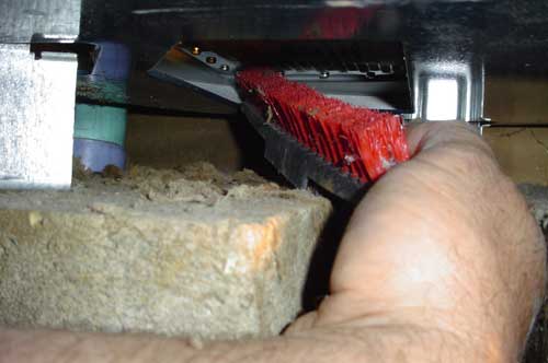

    Sometimes the "filter" needs cleaning under the water heater.
    1. The AIR INTAKE screen is small, and over time can clog with lint, dust, and hair.
    You must clean the lint off from the bottom of the unit and from inside the heat chamber every 3 months or it will not get enough air to operate correctly.
