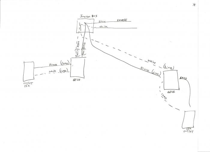

    Please see attached well crafted artistic rendering.
    I ran #12 wire from a 20A breaker to a junction box. From the junction box I created a pigtail and ran to the first GFCI outlet (Line) terminal. Also from the pigtail in the junction box I ran to a second GFCI outlet (Line). Then from the (Load) terminals on those GFCI's I ran to standard 15A receptacles.
    When I switched on the breaker, the first GFCI clicked off and none of the other outlets including the other GFCI outlets were hot.
    So I changed and wired so that the source went to the junction box. From the junction box I ran to only one GFCI (Line). From the (Load) of that GFCI I ran to the (Load) of a second GFCI.
    With that set-up, the first GFCI worked correctly, but none of the other outlets were hot.
    Shouldn't the wiring work as drawn?
    Thanks for any assistance with figuring out this wiring. It seems straight forward enough, but obviously I'm mistaken.

    You should be able to feed two branches with GFCI's in them, but why? All you need is one. All receptacles beyond the first one would be protected. No reason to break it into two branches. It's not a good idea to feed one GFCI from another, though (from its load side), but feeding two in parallel to their line sides should work.
    Your hots and neutrals are most likely backwards. The GFI will not reset when they are reversed.

    This should work as drawn. Probably something reversed, or there is additional loads connected on that load side and/or your neutrals are commoned together somewhere creating multiple returns paths.

    Never connect to the load when supplying a GFCI receptacle.
    The GFCI receptacle will not function should it be supplied to the load end of the device. Never connect to the load when supplying a GFCI receptacle.
    23,715
    The way you have it drawn, there should be no way either GFCI would affect the outlets on the other one. Feeding from the load of one GFCI to the load of the other one, turns it into an "junction point", not an outlet. (You could use wire nuts and do the same thing.) BUT, you said "when you turned on the breaker, the GFCI tripped", does that mean it happened automatically, and if so are you sure it was the GFCI and NOT the circuit breaker? If the GFCI did trip when power was supplied to it, then you have a wiring problem, NOT a GFCI one.

    hj, both the GFCI and breaker tripped immediately after I switched the breaker on. I must have a wiring issue. I'll have to check it out an be sure that I have it wired as drawn.
    I don't believe joining the neutrals from the breaker box and those going to the "Line" terminals on the GFCI outlets together in the junction box would be incorrect.
    I do have the junction box and outlet boxes grounded.
    I thought I'd solve the problem by taking the hot and neutral from the breaker to the "Line" terminals on just one GFCI outlet and then from the "Load" terminals to my other outlets. When I did this, the downstream outlets didn't work. This suggests to me that I must be wired to the wrong terminals on the GFCI.
    The reason why I wanted to originally use 2 GFCI outlets in parallel was based on the location of the outlets. Wiring this way would be more efficient.

    NO problem with wiring them if "parallel" if the wiring is done correctly. The GFCI will trip because of a fault, the circuit breaker will trip because of a short. The two situations are NOT always, or even usually, the same.

    hj, Thanks again for the reply. Here's what happened. I must have had a break in the wire insulation which caused a short. I rewired according to the drawing. My tester showed no power, but neither the breaker nor the GFCI tripped. I plugged in a light and worked like a charm. All outlets tested properly and responded to a manually tripped GFCI. I would not have thought about the tester being bad, but in fact that was part of this issue. Thanks again.
