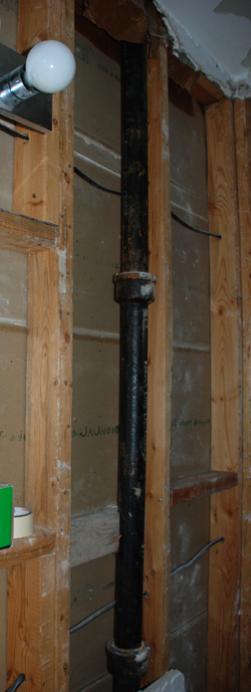

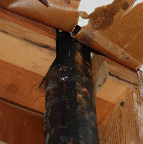

    So it turns out the collars on my stack stick out farther than the 2x4 construction in the room. As well, the stack was installed crooked so that the pipe, by the time it reaches the top plate also sticks out farther than the studs.
    Originally, I was going to get a section of it changed out to ABS because the sink installation I want is different than the original (I need the waste pipe higher because it's a wall-hung sink -- more like a tight install for pedestals). That would also take care of the collars. But now that I've noticed that the pipe also protrudes, what do I do?
    Do I get the plumber to increase the notch in the top plate and see if he can reposition the CI or do I get him to cut it above the plate in the attic as well as increasing the depth of the notch? Or can he install a smaller diameter pipe? Should I just change it out completely from just below the sink outlet through and out the roof?

    Because the walls were plaster on drywall lath, they punched through the drywall and thinned the coverage overtop of the pipe making it look like the wall was flat. It looks like the pipe is within the limits of the edge of the studs, but it isn't.

    If you don't replace the pipe, one option would be to fur the wall out a bit so the drywall/CBU will clear the stack.

    Thanks nukeman. I was trying to avoid that because it's such a small bathroom to begin with. Then I'd be looking at the toilet being almost in the way of the undersized doorway and I'd have to get a custom sized shower pan.
    The plumber just left and he suggested cutting out about 8 feet of the CI stack (he said it was 2 inch -- I assume that's the inner diameter) and changing it out to 1.5 inch ABS for that length. It would have a sink emptying into it and nothing else above that. Then, in the attic, it would join back up with the 2 inch CI.
    What do you think of that plan? Would 2 inch ABS be thinner than the 2 inch CI that's there? Will there be enough air coming in? Not that I don't trust the plumber but I just want a second (or more) opinion.

    A 2" PVC/ABS pipe is going to be about the same O.D. as the cast. However, the ABS/PVC won't have the hubs, so that'll save some space. As for dropping down to 1.5", it depends on what that line is venting more than just what the sink is draining into it. Might be hard to tell how everything is connected/vented, so it would be best to keep it at 2" if you can.

    CI is quite heavy. You may want to consider changing out everything above the point to ABS. If not, make sure that the pipe above is well supported, or you may have problems down the road with that heavy pipe on top of the plastic, which will bend. The inspector may not like it either.
    Would a second layer of drywall allow the wall to end up flat? Many toilets could stand 1/2" less between the tank and the wall, but each situation is different. IOW, how much does the thickest component stick out?
    Nohub connectors might be substituted for the hub on the CI to lessen the projection. Cut or snap the CI, and insert a small section of CI with nohub connectors at each end. The nohubs are only about 1/8-3/16" thick, so not much thicker than the pipe.

    A second layer of drywall is out of the question because of space. In total, my walls can't be more than 1 1/8 inches thick including drywall, mud and tile. The drywall is 1/2 inch, tile, 3/8 and mud probably 1/4. Plumber is going to make sure the pipe is supported in the attic before he does anything.

    Cut the stack just above the floor so there is NO hub above the floor. Then YES cut it up the attic as well. and replace it ABS. Also just leave the line 2" regardless of what it is. You should beable to hide 2" inside a 2x4 stud with no insulation behind it. Make sure put a clean out in as well.

    Thanks again, Doherty. I'll see if the 2" ABS will fit better and if it doesn't, I'll just notch out the top plate a little more. It doesn't have that far to go as is.

    Notch the top plate anyway. While you have the piping removed it will take you 5 minutes to notch plate. Then you know it'll be perfect.
