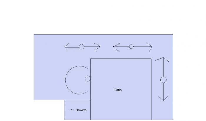

The 2-way heads available that I am aware of from Rainbird are the 9CST (9' x 18') and 15CST (4' x 30')
