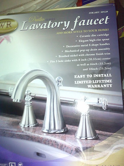

    So, my wife called me this morning and said she swore that she shutoff the bathroom faucet.
    When she walked by, she heard the water running and it was.
    So she turned the hot faucet handle back on and off, they were slow to shut off but than did.
    It is a Costco Waterridge faucet (Made by Danske I'm told), I know there are people who dont like them, but it's there to stay. It was a heavy solid piece that looked great and I was under the impression at the time that Danske was a good manufacturer. (It's brushed nickle w/ chrome accents and matches all other expensive bath hardware, so I don't want to go down that path.)
    Is this as simple as taking out the cartridge and bringing it to Lowes/HD to get a replcement seat and seals and tool?
    Thanks in advance for your help!
    -Mario

    Unfortunately, I think you are about to find out why people don't like them. Waterridge is a house brand and does not indicate who made it. It could also be Globe Union, who make some of HDs Glacier Bay and Pegasus faucets. Parts for all of the above are a stinker to come up with. You will need to pull the stem to even know what you are looking for. I think it going to be more complicated than a trip to the local big box. If you find the part, get extra - they may not be there next time.

    When I was looking for a faucet, I couldn't find one that:
    A) Fit an 8" 3 whole granite slab
    B) That looked half decent.
    When I saw this one, I was like "Wow".
    It was solid and heavy and looked well built.
    I'll update you after my phone call. lol
    -Mario
    Interesting how much it looks like the Pegasus though at HD P/N: FW0B5207BNC
    Even is mixed brushed nickel and chrome accents.

    First I'd like to thank you all for your input and to bear with me as I explain.
    No matter what shutoff valve I turned off or on, both hot and cold were slow to turn off.
    I took off the handle and decorative cap, which by the way were heavy and thick unlick the Kohler I had looked at. The valves looked good.
    One of the decorarive caps unscrewed the valve bolt with it and I couldn't remove them.
    So I had to use a whizzer to put a notch in the bolt-cap and pur the decorative cap upside down in a roll of toilet paper which happen to be the perfect size to hold it. I used a small screwdriver and hammer to tap it off.
    Once all back together, same thing it was slow to shut off.
    Took it all apart again and this time I took apart the ceramic cartridge by removing a small clip.
    I must say that before disassembly it seemed the valve wasn't closing all the way.
    Anyway, after taking both apart and back together it fixed the problem!
    Thank you all!
