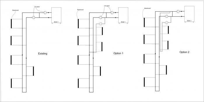

Can I add a zone like this?

Please refer to this diagram (attached or this link) to see my existing piping and my plan to add a new zone:
http://www.flickr.com/photos/oldyoungguy88/4796411070/sizes/l/
We converted from oil to gas last year and now we are thinking add two rooms into the system as a separated zone.
Please tell me "Option 1" is valid or not? if not, how about "Option 2"?
thanks,

Zl700
DIY Senior Member
257
Western NY
You have a monoflo system and wish to add a seperate controlled zone? Option 1 will screw things up, #2 is best with info provided.
