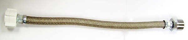

    I did one of these a year ago. forgot the braided 7/8 to 7/8 hose , when ordering
    I got lucky and found one in S.F. I feel the supplier should ask what the washlet is sitting on!

    I agree! I installed the ST416M tank on the CT416 bowl and Washlet and the 7/8 female 7/8male is mandatory. Not referenced in either set of directions. Unfortunately not available where I live and it was the 4th of July weekend coming up. It was a long trek to the other john at night for a while. But we love the new TOTO. LOL
    The part is a THU9090 by TOTO

    thank you, Now I don't feel quit so foolish !
