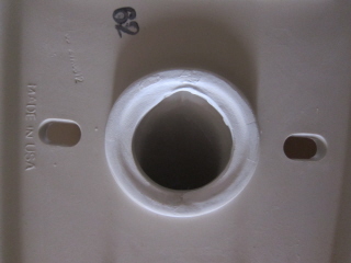

    I'm getting ready to install a Toto Eco Clayton. I looked carefully at the new toilet today and noticed two things I wouldn't have expected:
    1) Although the bowl is smoothly glazed, the trapway inside feels rough, sort of like 220 grit sandpaper.
    2) There is a lip inside the trapway exit that would seem to be able to trap things as they exit the toilet (see attached photo)
    Are these two things normal?
    Also, how do I know what size (thickness) wax ring to use? The flange is sitting on top of the bathroom floor, and it's 1 inch deep inside the flange. It seemed like I scraped a lot of wax out when I removed the old toilet. Thanks.

    If the flange is setting above the floor, then one wax ring should do it.
    If the flange is slightly below the floor, we use two.
    The roughness in the trapway works better then a smooth trapway.
    It's impossible for a baby wipe (which shouldn't be flushed) from sticking to the roughness of the trapway. If it' smooth, then things will stick to it.
    Imagine throwing a baby wipe at your bathroom mirror, it will stick.
    Then throw in on a texture wall and see which one falls quickest.
    We've sold thousands of bowls that look like that, it's the sweep before the outlet that makes the difference. The sweep points the waste down the drain.

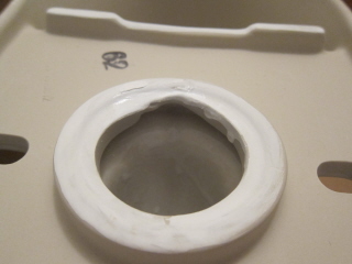

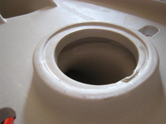

    First post. Although descendant from a proud plumbing family, I have no experience in plumbing. See photo of the horn on my new Toto Drake II CST454CEFG with C454CEFG bowl w/SanaGloss (1.28gpf). I expected the horn to be round and uniform all around, but as you can see, it's not on the side closest to the front of the toilet. Looking down on it, it is not round. Secondly, there is a 3/8" vertical ring of porcelain down into the toilet all around except in that front area where it's about half that. It this a defect? Should I return it to my local supplier Webb and get a replacement? (I uploaded 2 photos but don't see them, so if they don't go through, I'll try again.)

    Hopefully, here are 2 photos for the above post. I had to re-size them down (often blogs do that automatically so I had to figure out how to do it). I should take this opportunity to thank Terry and all of the rest of you who have provided so much help to me in selecting a toilet. Name:  IMG_4582_rs.jpg

    Jim D,
    It's nothing to worry about. They pretty much look something like that and we keep selling them and we keep getting happy customers.
    Once you have it installed and you are using it, it will just be a distant memory. We just installed six more TOTO bowls today, Drakes and Ultramax's. That's what they look like when you turn them over.
