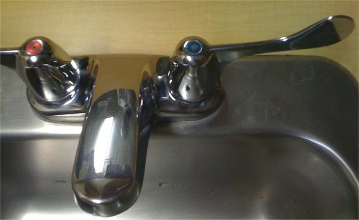

    Hi Y'all
    I am hoping someone of the forum has seen my type faucet before.. I have several of these that are leaking and am looking for help identifying the faucets. There are some at 4inch and some at 8inch, but with identical handles/screws (see below) - so a safe bet that they are the same company.
    the large ones (not pictured) actually say Delta in the front - but Delta customer service cannot identify the faucets.
    They all have a hex head (color coded to water temperature) screw in the handle - and most of mine have been stripped by someone using a Philips instead of an allen wrench before I got there.
    Questions:
    1. Can anyone definitely identify these as Delta (in which case their generic seat/spring will work)
    2. Any ideas on the screws - I can't seem to find anything on color coded hex head screws..
    3. Is the colored screw just to indicate temperature and should I be looking for a hidden set screw or some other way to take off the handle?
    Thanks/Micky

    Pull the handle that you removed the screw from and take a picture of the stem underneath it. THAT will be a better indicator of the manufacturer than the handle or screw.

    Moen has a commercial lav that uses colored TORX screws on the handles. It would help a lot if you took out the cartridge and posted a pic of what's inside that faucet. If it is seats and springs, delta parts probably work no matter who made it.

    Thanks for all the help - Delta seat/springs worked. The aluminum red/blue screws are special order.

    If you aren't worried about somebody stealing the handles, just use a regular slotted or phillips head handle screw.
