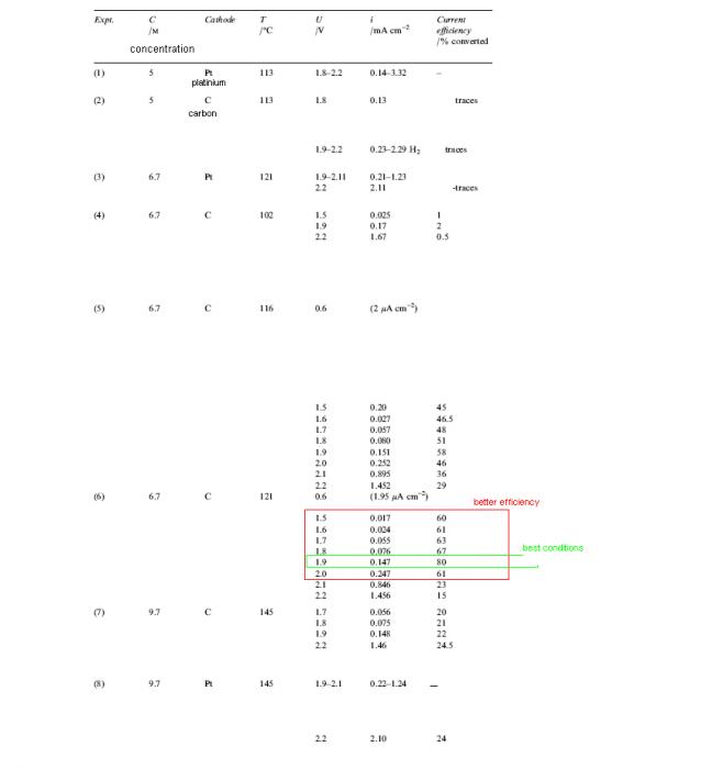

    here is the whole conditions i will work at it , i took it as prtscn to you
    some symbols like
    - C/M is molar concentration and it equals the no of moles of substances per liter of solution .
    - C carbon (graphite electrode).
    - pt platintium electrode.
    i think you know the rest better than me

    i forgot to say that the key condition in this test are :
    - electrode type
    - current density
    - temperature

    That helps a bit. Now the question is: What are you looking to do?
    1. Repeat this experiment and see if you get the same results (1.7, 1.8, 1.9v, etc.)?
    2. Are you looking to improve these results (finer adjustments between 1.8 and 2.0v and find the best conditions, perhaps using 0.02v steps)?
    3. Have you determined how you will measure the current efficiency?
    Ideally, you would want the voltage to bounce around less that say 10% of your resolution. So if you were using 0.1v steps (like in the table above), you would want the voltage stable to 0.01v or better (meaning if you wanted 1.8v, the actual voltage might bounce between 1.79v and 1.81v... less variation would be better). Now if you wanted 0.01v steps to improve on that table, the voltage should be stable to 0.001v or better. The other thing to consider is voltage drift. If these experiments take some time, the voltage might change while doing the experiment (depends on your voltage supply). So if the voltage supply isn't properly designed to compensate for this, you might start the experiment with the correct voltage, but the voltage might be different towards the end of the experiment.
    So, this is why I ask what you are trying to exactly do (what are your goals?). Finer adjustments require a better voltage source as well as better equipment to measure the fine voltage/current changes.
    Do you have the information on that voltage source from your electrical department? You could post the brand and model number and I could see if I could find the specs online for it.
    reduction of oxysulfur acid containig water to sulfide
    in other words convert HSOx to S (hydrogen is the most interfering spcs. here
  11. #56
    DIY Member aeacfm's Avatar
    Jul 2010
    egypt
    42
    Quote Originally Posted by nukeman View Post
    - exactly i want to improve the results , also the conditions may be different (but not too much)
    - i also want to try with these data to see if i will reach the same results or not.
    - i dont know to measure the current effiency but , also i want to control it .
