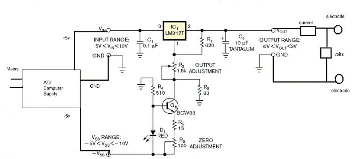

    It is a little confusing in what he talks about. You just need to do it like he shows in the circuit without any extra diodes.
    Here is what he is talking about:
    - normally, with the LM317 , the lowest output it can do is about 1.2v. However, we want to be able to get down to 0v. One way to do this would be to use the LM317 and add a pair of diodes (and have a negative voltage supply) to shift this 1.2v down to 0v. See, each diode drops about 0.6v across it, so 2 diodes would be 1.2v. Basically, you are just shifting everything down by 1.2v (so if you had a design that went from 1.2v-5v, now would go 0v-3.8v). However, he mentions that using the 2 diodes, there is a problem with drifting. What happens is that the actual voltage drop across the diode changes with temperature. This would not be very good, as your reference voltage would change and then your output voltage would change. His circuit removes this problem.
    - for power, all you need is the computer power supply. The computer power supply will convert your mains (110v-220v AC) to DC power. There are several DC voltages inside the power supply available (+12v, -12v, +5v, -5v, etc.). Take a look at the 2nd link that I gave you. You will use the +5v and -5v from the computer power supply to power the circuit.
    The circuit has two adjustments. One adjusts the reference voltage (to set where 0v is) the other adjusts the output voltage (0v-3v).
    You would then use a current meter and voltmeter to measure what is being applied to your electrode. I'll try to draw something up for you to make it clear.
  12. #27
    Nov 2009
    VA
    628
    Try this:
    This should work for what you need. If you can give me the exact electrode sizes, then I can verify that this circuit will be able to handle the current load. If it can't we'll have to try something else.
    Good luck.

    but other question just to understand the (D1 RED,R4 510, BCW33, R2, R6, R5, ) all in one component or what i cant get it ???
    other question if i will work for volts in the range from 1.2 V to 3 V you said that it would be easier , so how it will look like ????
    i am sorry i know i am wasting your time

    for one electrode the surface area approximately = 14.326 cm2
  15. #30
    Nov 2009
    VA
    628
    Each of the parts listed are individual components (resistors, capacitors, etc.). On the resistors (R1, R2, etc.), the number listed is the resistance in Ohms. R2 and R6 are adjustable resistors. D1 in an LED. Q1 is a transistor.
    The most simplified version of this circuit (1.2v minimum) can be found in this data sheet (1st page). You would not the the negative side of the computer power supply in this case. Also, you could use either +12v or +5v for power (it would be better to use the 12v to make sure you can easily get above 3v (but using the 5v would work fine too).
    http://www.national.com/ds/LM/LM117.pdf
    If your electrodes ar 14cm^2, we might need to go with a different design. Say you want a current density of 0.2 A/cm^2:
    0.2 * 14.326 = 2.87A
    This circuit will only handle 1.5A. (current density of about 0.1A/cm^2 using those electrodes).
    Would it be possible to use smaller electrodes for this experiment, or do you have to use this size? If you need to use this size of electrode, we will need something that can handle more current.
