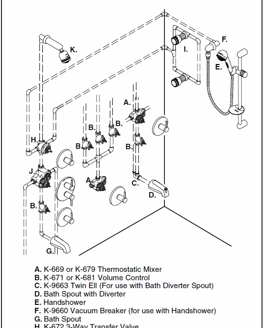

    I have heard that I should not use pex between a shower valve and tub spout because of resistance. I will be using a 3/4" thermostatic valve with separate volume controls for the tub and multiple shower heads; all 3/4".
    Having volume controls for everything including the tub, anyone see a problem using 3/4" PEx for everything and no copper as long as its all strapped down?

    You do NOT have the same dynamics in your design that a diverter spout would. ALL of your devices will have a positive shutoff valve in the line going to them so it makes no difference WHAT you use, or the size, to any of them, including the spout. A bigger issue, if the thermostatic valve has an on/off function would be that you should NEVER have all the volume control valves off at the same time. Even though the valve should have "check stops", you could leave the valve turned on, and stop the flow with the volume controls, which could create a "cross over/backflow" situation between the hot and cold systems.

    What I have is a Kohler Thermostatic valve, with no volume control built in. IT is meant to only control the temperature.
    http://www.us.kohler.com/onlinecatal.../1041158_1.pdf
    21,382
    Read the installation instructions very carefully. Many of them must have the water going INTO them turned off, i.e., not have the water OUT of them stopped. This is why most people use a multiport divertor valve rather than multiple stops. If it isn't obvious from the instructions (it may only be one line or word burried somewhere), I'd call the manufacturer's tech support line and specifically get their okay for your installation plan...
    DIY Junior Member tomtbone's Avatar
    Feb 2010
    tomtbone in Boston
    28
    This is what it says in the directions:
    The K-669 and K-679 thermostatic mixing valves do not contain an integral volume control/shut-off valve. You must install a separate volume control/shut-off valve (K-671 or K-681)
    downstream of any used valve outlet.
