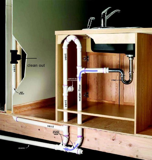

    Hey everyone,
    First I'd like to thank everyone who helped me set up my DWV, passed dry fitting inspection first try. Thank you.
    However, I had one fitting that the inspector wants me to change when I glue.
    My foot vent looks just like the first image except I put a clean out on the vent above the floor.

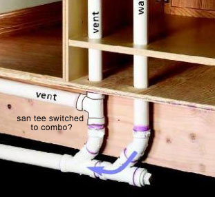

    My question is with the second picture:
    The picture here shows a San Tee being used, however my inspector wants a wye combo there instead. My first reaction at the time, do whatever the inspector says, but now that I'm gluing the combo is adding about 2", dropping the drain below the ceiling in the basement, which I was hoping wouldn't happen.
    Any suggestions? Should I challenge the inspector or just do it like he wants and deal with a drop ceiling?

    There should have been a cleanout on the foot vent, the drawin didn't show that.
    The santee on the vertical should be fine. It's how we plumb them in Seattle.
    The picture shows wye combos on their backs. Those are fine that way too.

    According to the way it is worded in the UPC the fitting should be a wye type (combo). It is up to the local jurisdiction exactly how they want it. Here in Hawaii the inspectors allowed a san tee in that position for many years. However with the influx of a new batch of inspectors they now require it to be a combo exactly as stated in the UPC.

    The UPC Illustrated Training Manual also shows a combination.
    25,687
    Put a 45, under the floor. The sanitary, (or even a street sanitary), tee on its back facing upward at a 45 degree angle with a street 45 restoring it to horizontal. Then out of the bottom of the sanitary tee into a "Y" on its back and you will not add any depth and will comply with the strict code interpretation.
    According to the UPC you cannot have a sanitary tee anywhere in the configuration under the floor, no matter how you position it. As I already said it really depends on how the local authority wants it as they have the final say in their jurisdiction.

    Here is how the UPC states the procedure of roughing in an island sink:
    909.0 Special Venting for Island Fixtures
    Traps for island sinks and similar equipment shall be
    roughed in above the floor and may be vented by
    extending the vent as high as possible, but not less
    than the drainboard height and then returning it
    downward and connecting it to the horizontal sink
    drain immediately downstream from the vertical
    fixture drain. The return vent shall be connected to the
    horizontal drain through a wye-branch fitting and
    shall, in addition, be provided with a foot vent taken
    off the vertical fixture vent by means of a wye-branch
    immediately below the floor
    and extending to the
    nearest partition and then through the roof to the
    open air or may be connected to other vents at a point
    not less than six (6) inches (152 mm) above the flood
    level rim of the fixtures served. Drainage fittings shall
    be used on all parts of the vent below the floor level
    and a minimum slope of one-quarter (1/4) inch per
    foot (20.9 mm/m) back to the drain shall be
    maintained. The return bend used under the
    drainboard shall be a one (1) piece fitting or an
    assembly of a forty-five (45) degree (0.79 rad), a ninety
    (90) degree (1.6 rad) and a forty-five (45) degree (0.79
    rad) elbow in the order named. Pipe sizing shall be as
    elsewhere required in this Code. The island sink
    drain, upstream of the returned vent, shall serve no
    other fixtures. An accessible cleanout shall be installed
    in the vertical portion of the foot vent.
    Again it is necessary to reiterate that local authorities ammend the UPC and interpret it to suit their own requirements. Just because the UPC states it a certain way and an authority adopts it doesn't mean they enforce it according to the letter. It is therefore necessary to find out how your local authority has ammended or interprets the code.
