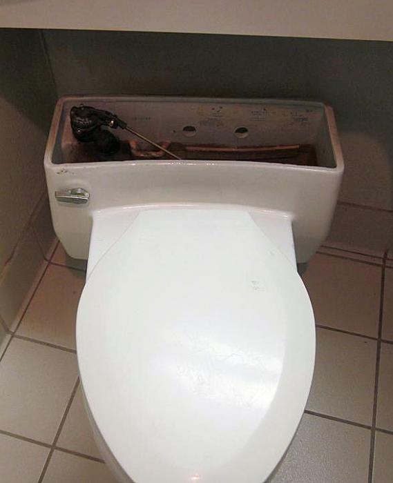

    You read it right. I got a $20,000 water bill recently and it's all due to leaky toilets. I am a manager at a 160 room hotel. All toilets are about 40 years old (pictures attached).
    I found out that it was a toilet problem after shutting down all toilets. After shutting down all toilets, the water meter stopped dead in its track...
    I have managed to reduce last month's water bill to $13,000 by religiously fixing running toilets. But there are still toilets that leak silently due to the fact that they are so old.
    But the bill at $13,000 was still way high, a 50% occupied hotel with 160 rooms should run about $2,000 to $4,000 in water bill every month.
    The problem is that our hotel doesn't have enough money to replace all of these 160 low profile one-piece toilets. Also, the retrofit kits are quite expensive at almost $200 per kit since these kits are made of brass and almost no-one manufactures them. I have been buying these kits from a Fox distributor but they cost so much and they only help partially.
    Any suggestions of where to get cheaper kits so we could replace all 160 toilets? Or any other suggestions would be appreciated.

    No, I'm serious. Our toilets use 5 gallons a flush. The real problem lies in the silent leaks. So if you know of a place we could purchase rebuild kits for these toilets I'd really appreciate that.

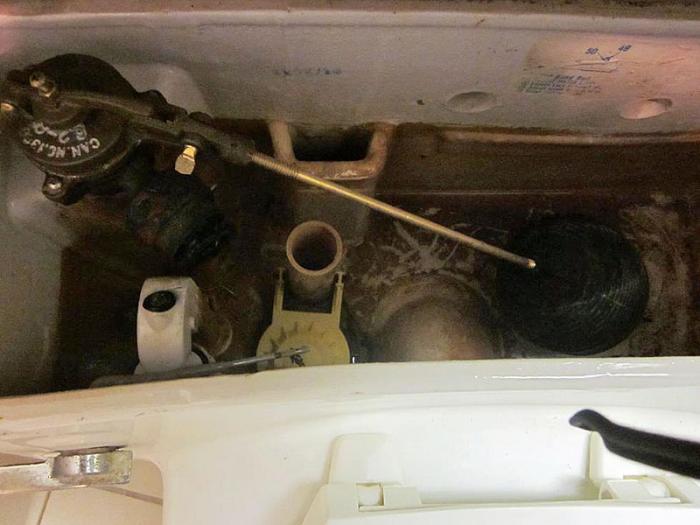

    If you could read the make and model number from the inside of the tank, we may find parts lists, especially if it is a Kohler, Case, or American Standard. But there are a lot of unique parts in there and a rebuild for an old toilet can easily be over $200. You need to let the owner know that it is seriously time to budget for new toilets. Are you part of a national flag? I am surprised they would let you continue to be a water hog. That is not good PR these days!

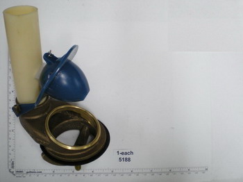

    There is no question about them being Case/Briggs low boys. In my opinion, the only BETTER one ever made was the wall hung version. One advantage of those, especially in a hotel situation, is that if they get plugged up they WILL NOT overflow and flood the room and the ones below it also, which would be my reason NOT to replace them. There are NO replacement valves, other than the Briggs OEM, but the only parts you need to repair them are the stem, seat, and "disc", about $25.00 total.

    Thanks HJ. You're exactly right, they are Case/Briggs low boys. I'm just wondering what "seat" and "disc" are? I 'm guessing you're saying that "stem" = "metal rod"... And where would I be able to find those parts for about $25 total?

    On the other hand, for the past few days, I have found out that most of our "silent leak" problems come from the fill-valve. I'm just wondering where to buy these lo-boy fill valves. I found one on google but I'm not sure it'll work with Case/Briggs lo-boys that we have => http://www.idealtruevalue.com/servlet/the-83090/Detail
    I also measured the inside tank. The inside tank height is about 10 inches.

    What you have is a very large bowl refill tube.
    The little refill tube on the Ace Hardware item is unlikely to move the water in the bowl.
    It's an illegal valve though, it can cross connect. There is a reason that toilet fill valves are higher then the water in the tank.

    The "stem" is the piece that moves up and down inside the fill valve. The seat is the plastic piece inside the valve that the stem's washer seals against, and the disc, is a black plastic piece that slides up and down on the outside of the stem. Any Briggs or good plumbing supply store will have the pieces. If you can buy them separately they will be about $25.00. If they only have them in a kit, it will have other parts you do not need and possibly a flapper.
