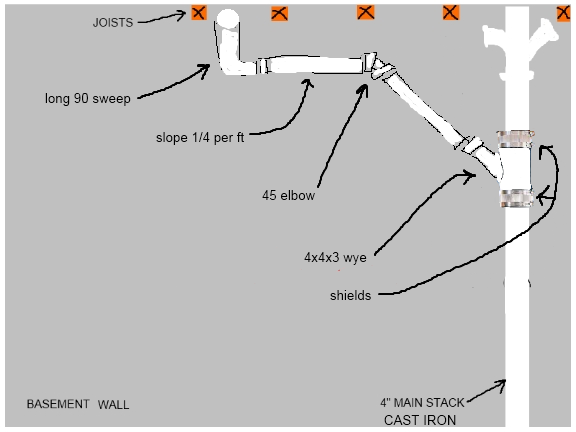

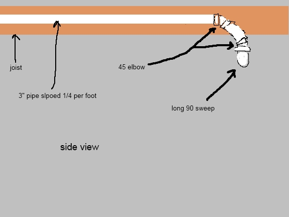

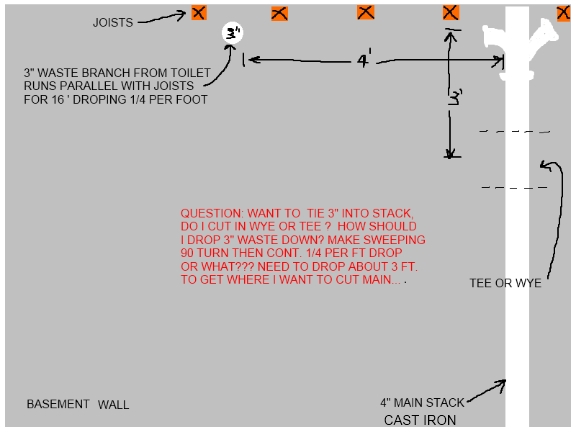

Heres my problem, I am adding small powder room and need advice on connecting to main stack.
Layout is done, everything vented and proper pipe sizes,,, just want opinions on best way to connect to main stack. I got my diamond torch blades ready for cutting but I am not sure if a wye or tee fitting would work best? And how to drop down the last 3' within a 4' span?
I am going to hopefully include a rough drawing with this post ( I'm new so I hope I can do it)...
New York State Code
