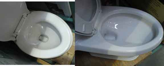

Low Flush does not mean you have to have "skid marks"
I'm sorry I couldn't have posted this 6 months ago. Hopefully someone else can benefit from what I have found. I've been looking at getting a new low flush toilet for my home for a while now. At work, they had put in new commercial noisy units. I noticed very quickly that they are prone to skid-marks. I did not want this effect at home.
As of July 2010 Costco was selling two models of a dual low flush 4/6L.
- A one piece designer "new" style (14.75" tall - floor to bowl seat)
- A two piece older style (16.5" tall)
A friend installed a Costco new style unit. From his feedback, there were skid-marks. "They go away after a few flushes".
I ended up getting the two piece unit, so far not a mark to been seen.
After closer inspection, this is what I have determined.
The lower profile unit has a shallow amount of water in the bowl. As well, the outlet is at the very back of the bowl. Things have to be dragged to leave the bowl.
The two piece is almost 2" taller. This allows deeper water in the bowl. The outlet is also more central to the drop zone. No drop and drag :)
I almost forget, it was only $85 and in my humble opinion it does look cheap either.
So if you don't want skid marks and you don't mind a slightly higher seat, this it the type to go with.
SteveRbm
Alberta, Canada
Oops, I meant to say, it does NOT look cheap. Also, the picture is showing the two different toilets to show where their exits are.
