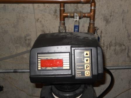

I apologize in advance if this info is already out there but I can't find it and that is why I'm here. Like many others I recently purchased a house and I quickly realized I know nothing about water softeners.
But this is what I do know:
I have a Cole and Massey water softener that has a separate brine tank from the resin tank. The rated service flow is at 4 GPM. It has a digital display with 4 buttons: up/down arrows, program, and extra cycle.
Now when I hold the Program button in for about 5 seconds it takes me to a screen that starts w/a H followed by a number such as "H------29". I assume this is my Hardness setting? It ranges from 1 - 128. Then if I hit the program button again I get a time setting and right now it's at 2:00 AM. After I hit Program button again I'm back to my current time being displayed which switches back and forth from current time to volume remaining.
Finally to my question: How do I program this thing? At the moment I haven't done a water test to see where I am at so I won't have all the information you may need. Right now I'm just wondering how to set this thing up once I do have all the information.
Any suggestions will be much appreciated. Thanks for you help.

They used to have a highly proprietary Fleck 5600 but it sounds as if you may have a 5600 with an SE timer. Go to
www.Fleckcontrols.com and look at some pictures to find out what valve and timer you have.
Then get hardness, iron and pH tests if you are on your own well, if not get the highest hardness data from the water company's web site and use it.
Then you need to tell us what size softener you have by measuring the width and height of the resin tank or looking for a model number on a label on the straight sides of the tank; a model 948 means 9' x 48" tank and that is a 1.0 cuft softener.
Then tell us how many permanent residents live in the house.

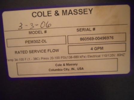

I have uploaded a couple of picks of the head unit. We are on well water and there are only two adults in the house. I won't be able to test the water until tonight so hopefully I'll have the results to you by tomorrow.

The good old 6600 from Fleck...
There are two levels of programing.
There is a hidden bottom that needs to be pushed for entering the sub level.

Aw, a Fleck 6600...good to know.
