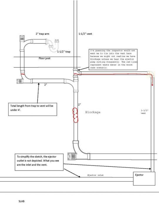

    What you describe on the framing is normal framing. We manage to plumb correctly under those circumstances daily.
    A plumber would have it done in less time that it takes to type this. It's that easy.
    Do you want pipes coming up through the cabinet taking up space?
    It seems a shame to cut up a new cabinet for a pipe that shouldn't have been there.
    The finish carpenter is going to love you for making his job harder.
    I am the finish carpenter. I'm actually interested in learning the proper technique for my personal edification, so if I've missed an easy solution, I want to learn.
    Plumbers typically aren't interested in doing small increments of work, and rightly so, without charging me a hefty flat fee per service call. The nature of my remodel is such that the plumbing, flooring, and the drywall must be done in small increments.
    With a standard installation, I would have to punch a hole into an adjacent cabinet, saw a large hole for the 45 degree vent (I need to offset because I can't shoot straight through the sill plate without cutting a 1" deep channel down my rim joist), and punch a hole for the drain line through the bottom of the adjacent cabinet.
    I could also run the trap arm through three cabinets and into a bearing wall, but I believe this wall sits directly on the main girder.
    Going straight out the back of the sink base cabinet is not possible because the window sill is built up with horizontally stacked 2x4s to accommodate a window that was significantly shorter than the original rough opening. Even if we had cripples below the window instead of solid wood, I'm not sure I could get the vent up to 42" before going horizontal. I would also have to put a 2" hole through 2x4 king and jack studs, which would require some sort of Simpson tie reinforcement.
    If I'm missing a really obvious solution, please let me know. I would prefer to keep all the pvc in one cabinet and drill a single hole in the cabinets.

    a 2" trap arm/drain is sufficient to avoid siphoning on a 1-1/2" p-trap. Can anyone corroborate with a real-life anecdote?
    A lot is to do with the distance between the trap and the vent. I have a 1.5 inch p-trap on a 1.5 inch pipe for my laundry tub. But it is just over 42 inches away from the vent. The trap gulps after the tub has drained. I am going to have to shorten the distance.
    If you have just shy of five feet of pipe between your trap and your vent then you will need 2 inch pipe. Any more than 5 feet and you will run into the same problems as me.
    Although Table 12.8.1 shows something different. Where am I going wrong here?

    Well, the table specifies lengths based on the trap arm size (1-1/2" in my case). A 1-1/2" trap corresponds to a developed length of five feet. If the drain is horizontal until you hit the sanitary tee for the vent, you should still have 18 inches to remain code compliant. In fact, according to the table, 42 inches should be fine for 1-1/4". Are you dipping below the crown weir before you tie into the vent? You can have up to 3 DFUs on a horizontal drain, and I believe a standard laundry tub counts for two. I'm not a pro, so I'm not the best one to help you troubleshoot, but I would make sure your vent is clear of obstructions and that the p-trap is not reversed.

    I would follow terry's recommendation come out of the top of the tee 90
    over below your
    stacked wood, then outside the window space 90 up though the roof is
    how real plumbers would get it done,
    or install aav on top of the tee as high as possible

    The trouble is those stacked 2x4s start at about 38 inches above the finished floor. I'm pretty sure the inspector will not allow me an exception from the requirement to keep that horizontal vent six inches above the flood rim of my fixture. In NJ, we have to have an engineer design the AAV. He might allow me to augment the combination waste-vent type installation, but I'm a little reluctant to introduce a mechanical vent that will one day fail and introduce sewer gas into the house. Do you know of an AAV with some sort of fail-safe, i.e., it automatically closes off when it fails?

    I think the branch vent below is very dubious, but how does the rest of the sketch look?
