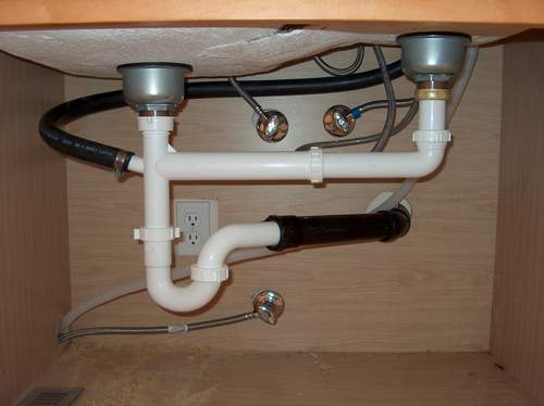

I have the exact same setup in my kitchen and it works perfect. It was originally plumbed with no vent at all and running one up thru the roof would have been impossible.......I have an old double sink just like in the pictures. I used a Studor AAV.....It can be changed in minutes and is just above the bottom of the sink just behind it....

Both sinks through one trap:
Both sinks with individual traps draining into a common 2" branch line via 2x1.5x1.5" double san-t (or double fixture tee if you can get it) with a 1.5" vent coming off the top into a 1.5" aav.
