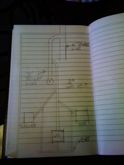

i was wondering if you can run shower and tub drains to the 2" lav wet vent to the toilet?
i don't know if the code is different in ontario. do the shower and tub have to have their own drain connection to the 3" toilet pipe.
That is not a proper wet vent design.
The lav is a proper wet vent, but the tub and shower having "flat" vents are not proper.
Nothing there will meet code. I wish I had the capability to draw it out for you but at this point I don't think you understand DWV well enough to be able to design the thing by yourself. Besides proper venting, proper slope, distance and use of fittings all comes into play not to mention how everything changes once the framing is in place. You need a professional to do this before it winds up costing you twice what it should.

btw 3 piece wet vent.

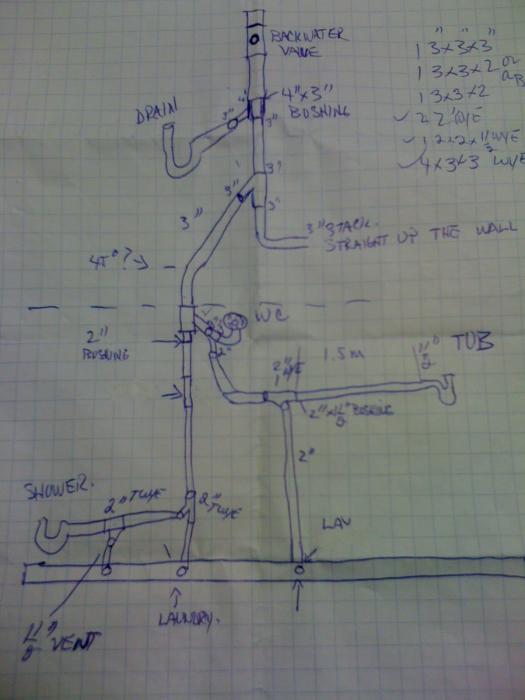

The green circle is your a-typical wet vent of a bathroom group. There is nothing wrong there at all.
The area circled in red is a concern because that appears to be a 1.5" flat dry vent. If it is you can't have a vent run flat like that until it is at an elevation of 6" above the flood level rim of the highest fixture it serves.
The area circled in blue is a floor drain I am assuming. If it is this is also perfectly ok and hopefully it's a 3" floor drain so you can classify it as an emergency floor drain.
the red area is a flat vent for about a foot and then straight up the wall to above the flood rim level, but i will use a t wye at 45 degrees and i think it will be acceptable am i correct mr. doherty
and yes a 3" floor drain, and thanks for chiming in.
No the red area is not to code because the lav dumps into the tub drain then into the toilet line. The wet vent can not come off a branch of the main drain line.

Not by the 09 IPC it ain't. You can not have the wet vent running off a branch from the main line. In that particular drawing there is no vent for the tub if the lav is draining
