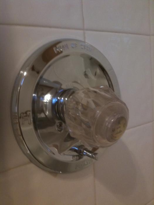

Delta 1606, but usually the model number is irrelevent, as long as the screw holes are both on the bottom and it has the diverter hole. In a pinch, you could get a "diverter plug", use the regular trim ring, and then replace your spout with a diverter spout. This would probably be the way to go, especially if you are looking for anything other than chrome plated finish.
