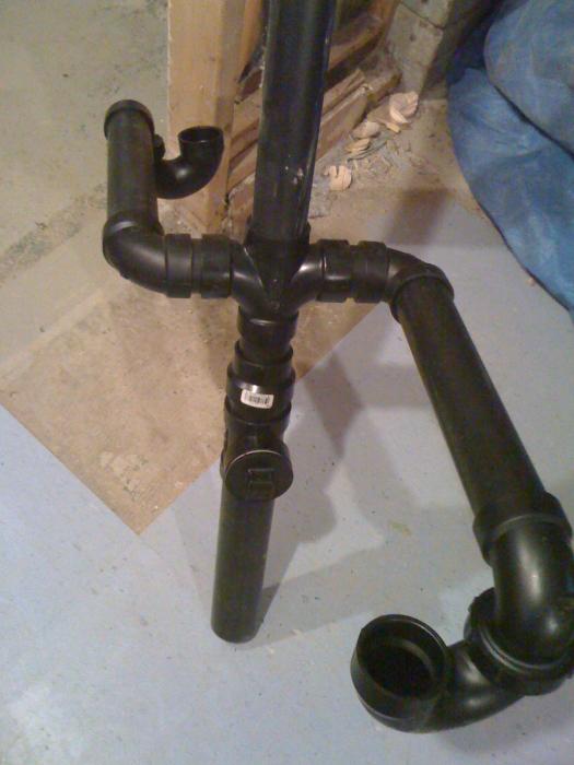

  3. #33
    DIY Member christoff's Avatar
    Dec 2007
    Toronto Canada
    Give me a couple of hours and I will post a picture of what you can do.
    any chance of getting that picture terry. thanks

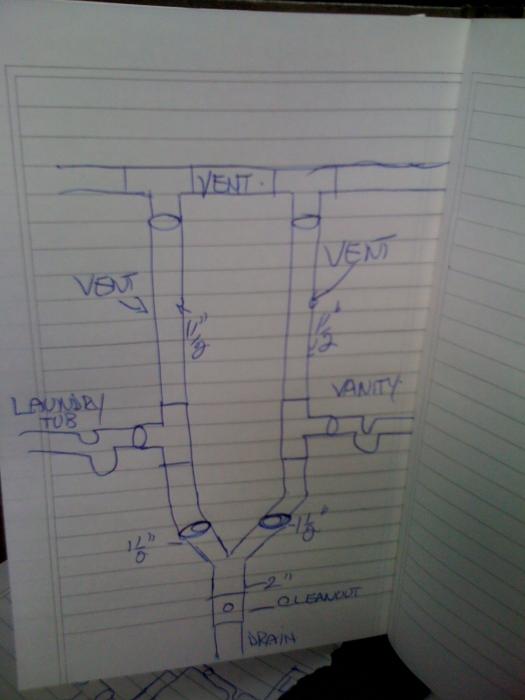

  5. #35
    Dec 2007
    Toronto Canada
    well could this be another possibility.
  6. #36
    12,428
    You have 2" from the bottom?
    Then why were you showing a 1.5" double san cross before?
    The laundry tub should have a 2 x 1.5 x 1.5" santee if you are coming up from the vertical.
    Or the 2 x 1.5 x 1.5 x 1.5 fixture cross would have worked.
    The picture below is a 1.5" being split for two lavs without the cross fitting.
    To be UPC legal, it would need 2" until it's split.
    But if you only had 1.5" in the floor, this would be the best fix.
  7. #37
    Dec 2007
    Toronto Canada
    yes this looks alot more compact than mine, would mine even pass terry?
    the 2" is the main drain that will go to the 3" drain. i have the toilet wet vented through the lav as the last vent before the entrance to the 4 " drain to the sewer
    i was showing the san tee last night when you said you were going to post a pic, then i tried to draw a pic as well hense the new setup.
  8. #38
    Dec 2007
    Toronto Canada
    this is what i was going to do until i was told not to use a double san tee
  9. #39
    Jun 2009
    Penticton, BC
    812
    Quote Originally Posted by christoff View Post
    I'm not a big fan of the short sweet 90's you have there, but if you changed those to 45* elbows your setup would be 100% code legal here in Canada.
