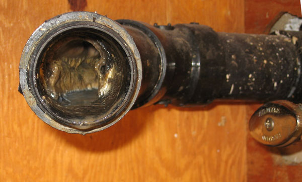

    I'm getting hungry just looking at this
    Looking inside a sink drain, you know this stuff smells good.
    Stuff we find inside of pipes

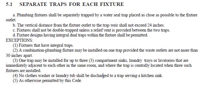

    Yes, you are correct and I apologize for my lack of knowledge regarding plumbing terminology. I am not a plumber, but a DIY who is looking for some good advice. I have another bathroom vanity that was converted from single to double about 8 years ago. We used a local plumber. In that bathroom the drain opening was into the wall forming the right side of the vanity. The plumber added a wye horizontally and connected each sink (with its own P-trap) to the two ends of the wye fitting. We have never had any problems with the functions of the drains, nor have there ever been any odors emanating from the drains of either sink.
    In this case I am looking to do it myself and can see two alternatives. One would be to do the same thing as that plumber did 8 years ago; put a wye on the centered drain opening, put a trap under each sink and connect everything together. Another option would be to use either a center or end outlet continuous waste kit and only one trap. Despite all that I have heard on this site, I still don't see why one of those (or both) wouldn't meet my 3 criteria: it works, it's safe, it meets code.
    It works in my other bathroom. Hard to see what could be unsafe about it. And our town uses the National Standard Plumbing Code. I've attached the section on Traps. From what I can make out, the option of using a single trap should be within code. Separate traps are not required for lavatories which are adjacent to each other in the same room. I also couldn't find anything that said that my first option, using 2 traps and a wye, violated code (although it could be buried somewhere and I missed it or didn't understand it).
    So I'm still looking to hear why neither of these options is appropriate. I understand that you wouldn't build it this way if you were starting from scratch, but if there is an option that works, is safe, and meets code and that doesn't require taking the wall down, then that's the option I'm going for.
    If I'm missing something, then please tell me. And if one of my two suggested options is better than the other I'd like to know which is better and why.
