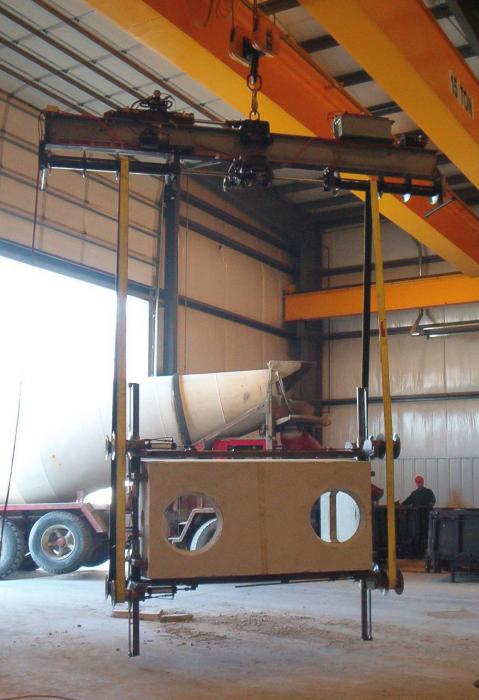

    If I understand this correctly we have an overhead crane that is powered by 480 volts.
    This crane has two 12 volt direct current electric motors that operate an air compressor and a hydraulic pump.
    The operation of the crane and both the compressor and hydraulic pumps are controlled by a pendant that hangs from the crane which the above drawing is supposed to be of.
    Well I am going to leave this one alone as I just don’t see the crane lifting and lowering with only two wires to the motor controler but will ask why these tanks that are designed to be buried underground must be handled so delicately? Are they not reinforced by some sort of rebar?
    Yes, and that bridge crane has its own wireless controls for travel, lifting and lowering and speed.
    Quote Originally Posted by jwelectric View Post
    No. What we have here is an I-beam hanging on the crane's hook, and everything I have mentioned is on that beam. Here is a picture from one of my early tests during fabrication:
    Only the hydraulic pump and leveling system are in this picture, and a 480V turn motor and the compressor and control pendant were added as my work continued.
    Ultimately, I installed a cord reel to bring 480V down to the hook and power everything on the beam from there.

    ... but will ask why these tanks that are designed to be buried underground must be handled so delicately? Are they not reinforced by some sort of rebar?
    Certainly, but the concrete is only a little over 12 hours old when the halves are pulled from their forms.
  5. #20
    Jun 2007
    North Carolina
    2,227
    Cool Dude and thank you for the explanation. I was having a hard time with the pendant and thinking it controlled the crane as well as the beam.
    I can also understand the pulling of green concrete in only 12 hours of pour. Having done some work at a similar plant I suppose I was thinking of your plant being like the one I did service work at. There they had break away molds that were opened in the yard.
