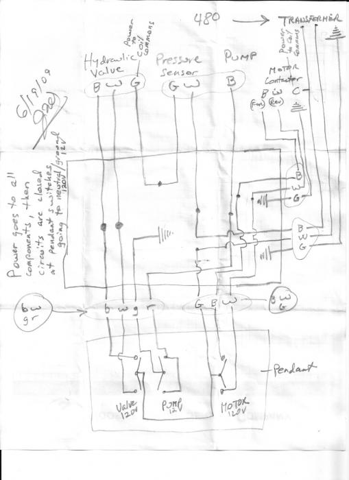

    First, because the only thing I actually know how to do with *3-phase* power is that of wiring and connecting contactors and motors. But beyond that, I needed control voltage and pendant wiring for a 110-volt double-acting hydraulic valve (for leveling the beam hanging on the hook) as well as for the reversing starter for the turn motor for the drums and straps ... and along with that, I needed a 12-volt circuit in the pendant for starting the hydraulic pump in conjunction with the aforementioned valve ... and I already had 120VAC available since it was needed for charging the hydraulic pump's and air compressor's battery. But of course, maybe 480 for all of that would have been much easier for a real electrician, eh?!

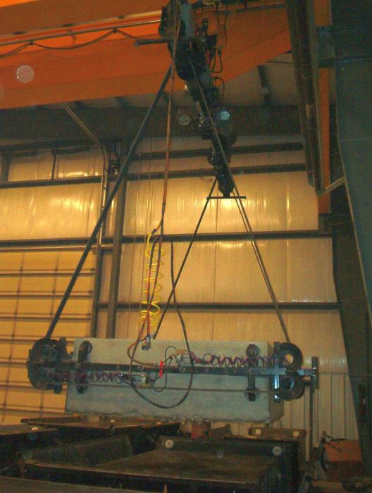

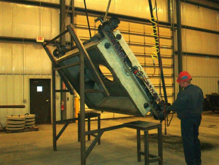

    What you see there is half of a septic tank coming out of its form. If it is a top half, it will need to be turned on its side so it can be coated inside ... then turned back and moved to a staging area where it can be set on the floor and released so it can be taken on out to inventory. If it is a bottom half, it needs to be turned rightside-up and hoisted over and released in the staging area ... and to complicate things, the clamp holding it has to adjust to fit five different sizes of tanks ... and that is where the 12-volt air compressor comes in. With its battery supplying power up on the beam, it (the compressor) sends air down from the beam to power the cylinders that close and lock (via air checks and rod locks) the clamp.
    But before any of that can happen, and after the clamp has been engaged around the tank in its form, the beam's hydraulic system is used to level the load so the tank will not be stressed and broken when first lifted. So, and with the air controls directly on the clamp, the first control at the pendant is a DPDT switch for controlling the 12-volt hydraulic pump (on/off) and its 110-volt hydraulic direction valve.
    The other control at the pendant is an SPDT switch for the beam's turn motor.

    The only thing I know to actually be wrong here is my mis-use of one green wire.
