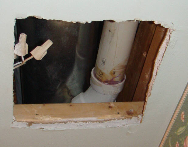

Ran into a bit of a snag. I did not completely pull the old fan prior to ordering the new fan. I just pulled back one of the edges and peeked through the gap with a flashlight. If I were to have pulled back a different edge or pulled the existing fan housing I would have found a couple of things running directly above the fan.
I pulled the old fan after receiving the new fan and this is what I found.
I could have worked around the drain line by shifting the fan over a bit and fix the gap in the drywall. The real problem is the HVAC duct.
Low profile Panasonic fan is now on order...

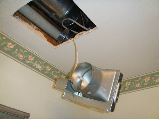

The deed is done. While I was waiting for the new fan to arrive I enlarged the hole, added framing below the drain line, and patched the drywall in the gap that was left after shifting the hole over to clear the drain line. The Panasonic fans have a removable "adapter plate" which is what is attached to the electrical wiring and duct. In this type of install, it can be put in place before sliding in the fan housing. Here is a picture of the adapter plate hanging from the electrical:

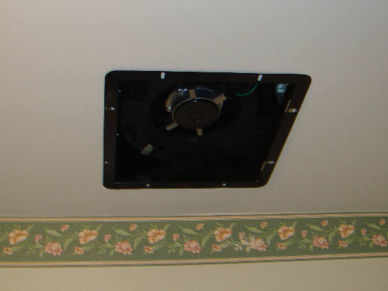

Once the electrical was wired, the adapter plate was put in place and the duct attached and secured to the adapter plate. I slid the housing in place, which pretty much snaps into the housing and put screws in the housing flange to secure the housing to the framing. In my case, the framing was in an "L" shape. Here is the fan in place without the grill installed:
Ah, so much quieter now https://terrylove.com/forums/images/smilies/smile.gif
