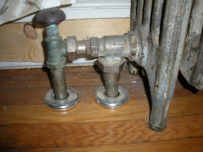

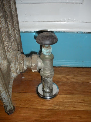

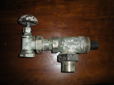

    All of the hot water radiators on the second floor of our house (1929 construction) have a valve, then a tee on the same side of the radiator. The water comes in from the vale, through a center passage of the tee and into the radiator.
    I assume the cold water is then forced out through the outer passage of the tee and down the return pipe. Is this an old type of monoflow tee?
    Does anyone know why are the second floor radiators like this, and the first floor ones have a feed pipe on one side and return pipe on the other?

    Boy, havn't seen them in years. Yes, the water flows through the inside pipe and back down the outside and 99% of the time they were on a mono flow system. No clue why they split it up but it probably had something to do with keeping the pipes close to each other to minimize holes in the ceiling and such

    The house was built in 1928-29 and the radiators/piping going to them appears to be original. I'm not sure why they used them upstairs either. I have to replace one of the radiators, and the valve has some issue and is no longer available. I guess I'll just plumb the replacement in a similar manner to the first floor radiators.

    You will need to remove the plug from the other end of the radiator and pipe the return to there.

    Those co-axial hot water radiator valves were very inefficient unless the "probe" extended all the way to the opposite end of the radiator to provide maximum circulation.

    If the radiator had a larger tap for the bushing, you might have been able to use a "double tapped" bushing used in the oil industry, but you will probably just have to run the return under, or behind, the radiator back to the riser.
