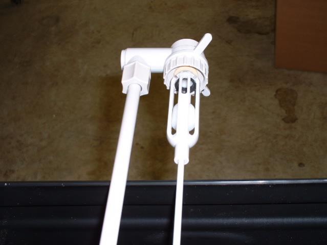

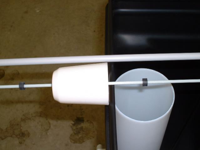

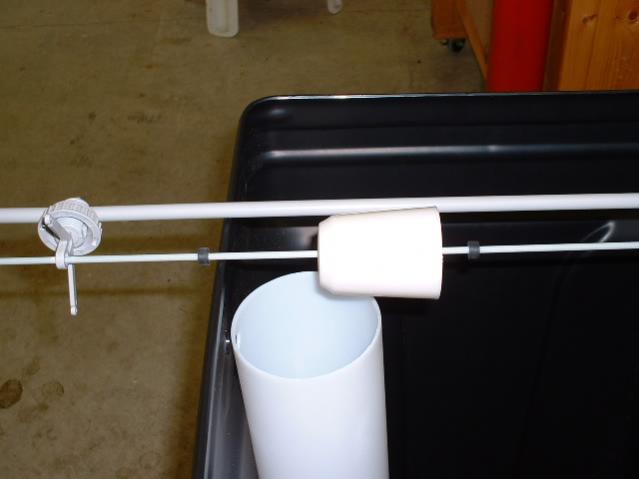

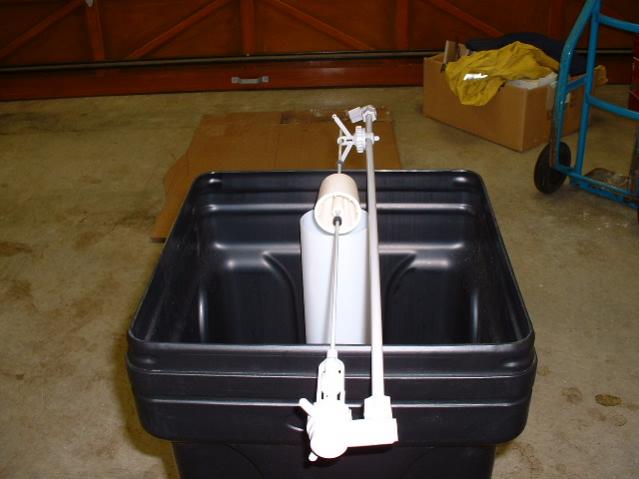

    I am curious to know if the lower o ring needs to be set somewhere on the shaft. The upper one needs to be set so its just below the overflow fitting but the lower one was set on the bottom of the shaft. The float moves up and down freely but should the float rest at the bottom of the shaft and rise up and down with the water level or should it be set higher up so it only hits the top o ring in the event of a malfunction??Name:  Brine Float 002.jpg

    Shoot the thing now before the headaches start....
    When I come across this kind of float assembly I put in a request to change it out with the 2310 safety float assembly as I have had next to no problems that 2310 plastic or brass.
    Yes brass fell to the salt air but out side of that challenge .. no problems.
    The one that you have has in my view to many things to go wrong and be a real pain ...

    Curious to know what part is crap? All of it ?
    Dec 2009
    Alaska
    1,471
    The bottom part has its challenges, some times not seating right. If there is some salt or any thing else that gets in and around that rubber disk that can cause it not to work right.
    The float rod can be a challenge, if there is a problem with it not filling trying to push down on the whole assembly could break the rod as it is of a plastic ..
    It is much like the cheap Sears GE softener float... if any thing goes wrong they have made it cheaper to replace than fix.
