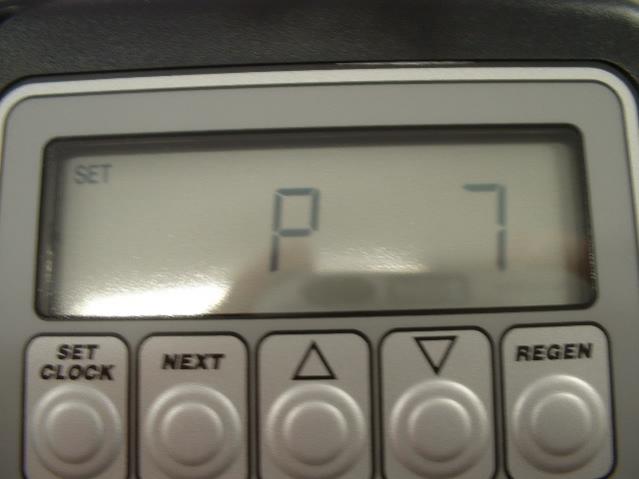

    DIY Member farmboy101's Avatar
    Apr 2010
    Vancouver Island
    46
    Default I do have a CS version valve after all
    Quote Originally Posted by Bob999 View Post
    As I posted in the previous thread the difference between the various Clack WS1 heads is in the programming and programming features. If you go to the Clack web site there are manuals for each of the versions and you can see how the programming process and options are different. With the CS version of the electronics the times for the various elements of the regeneration cycle are chosen by entering a P code--P1 or P2 etc. The EE version of the valve provides the greatest programming flexibility because the time for each element of the regeneration is entered directly.
    Go here to see the various manuals:
    http://www.clackcorp.com/water.htm
    Ok bob999, after going there and getting the manual for a CS version I discovered that I HAVE the CS version.
    The computer programs exactly like the manual and is set for P7 for regeneration. I unlocked the computer using the sequence of buttons as stated by the manual.
    The one I posted came from the Aquatell site as I did not get a manual with the unit and must be out of date and or wrong because I asked Aquatell pre purchase if the valve was the CS and they said yes it was.
    So I have entered all of the values except for changing the P #. What should it be??Name:  WS1.jpg

  15. #30
    Apr 2010
    Vancouver Island
    46
    M1 means nothing to me. As I think I said, your programming says it is the original version. I can tell by the dn in the programming. The CS version manual on the Clack web site has CS on the front and the programming asks for a P number, yours doesn't.
    I have a CS version after all. What P number do you recommend?? It is set to P-7 now.
