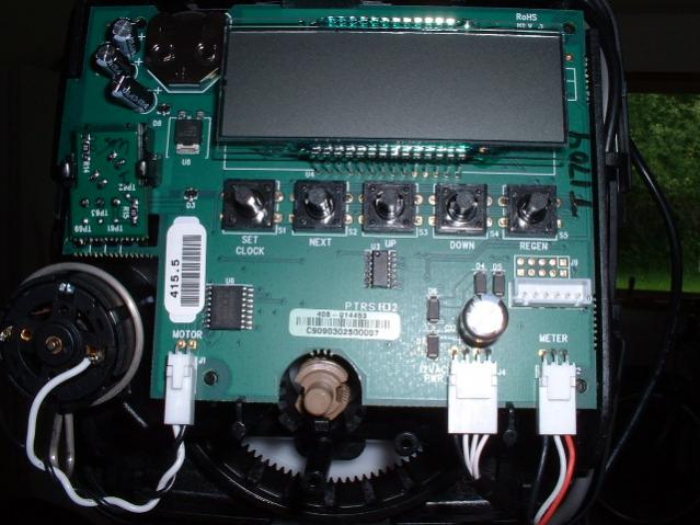

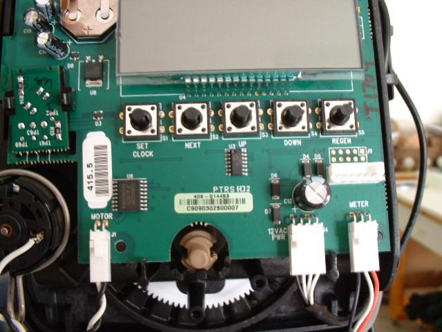

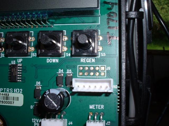

    Farmboy... you didn't get a CS version. You have the original version and the salt dose efficiency setting is used to set the length of time of the various cycle positions of the regeneration with the exception of the refill cycle.

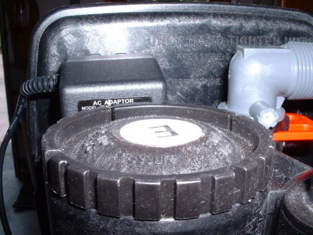

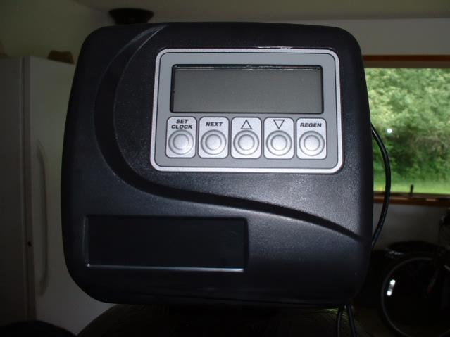

    Here is what I have. I was told that it was the CS version. The tank is 12x52. The packing slip says WS1MI. Does that mean anything??
    Gary Slusser
