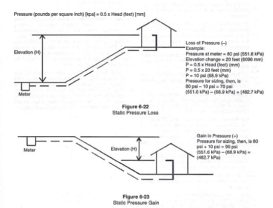

Okay, so bottom of tank is ~25 ft above the garden area. This will give ~12psi + 1-2 psi if the tank is more than half full. The angles and how you run the pipes won't make this any better. To increase pressure, you need to either:
1. raise the tank
2. lower the field where the garden area is
3. add a pump
The static pressure (no water flowing) will be the same no matter how you run the lines or what size they are. You'll end up with about 12psi or so any way you do it. The dynamic pressure (water flowing) will change with size/layout.
Best way to do this is to look at pressure and see how much gpm and throw these heads have at that pressure. The manufacturer should have this information. With the throw, you can see how many heads you need (spacing). Once you know that, you can figure out total gpm (number heads * flow per head). With that, you can usually find some tables that show pressure drop for a certain size pipe at a certain flow. This pressure drop will drop your 12psi by whatever amount. This will lower the flow/throw of the heads a bit. As the pipes/fititngs go larger than what is needed, this pressure drop becomes less. Since you are working with lower pressure, it would be best to go with the largest lines you can (within reason). For instance, say 1" was big enough to support the flow. You could go 2" instead and gain some performance for not much extra cost. However, if 1" was enough, it would be silly to run 6" or 8" instead. The cost would be much more and performance would not be much better than using say 2".

Static Pressure Gain
I found this nice little picture on pressure gain for the water supply in a home. It also has lose of pressure.
