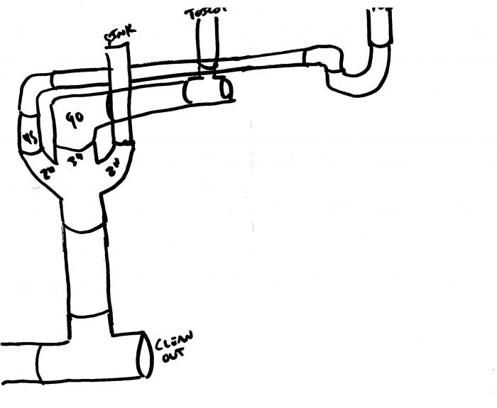

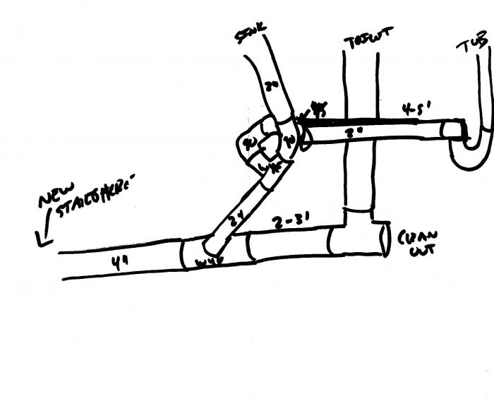

    So heres the current and the proposed new we're talking about
    Current - yes, it really does a 180 degree bend from tub to hook in.

    Proposed:

    Jan 2008
    3,151
    If you change it, you will be required to bring it up to the current code for your location. This includes the required vents.

    The fitting at the bottom of the stack should be a wye and 45* bend, not a tee.

    Quote Originally Posted by Doherty Plumbing View Post
    Yeah... all the tee looking things are actually wye + 45. Just couldnt get that detail with my crappy mushed up sharpie.

    Quote Originally Posted by atuel View Post
    Anyone have the min code for vertical drop before a p trap?
    And how would you vent the shower properly since its 5' over from the current vent ?
    You probably won't find a code minimum drop for a fixture outlet pipe. You'll find a max but not a min.
    You are allowed to connect to a vent upto 6' away on an 1.5" drain when running the trap arm @ 2% grade (which is the code min usually). This rule also applies when tying into a wet vent.
    What you have "proposed" in your above post is unacceptable because you appear to be s-traping fixtures. You need to tie into your vents with a fall that does not exceed the size of the pipe. This is to say that if you are running a 1.5" drain at 1/4" per foot you can run 6' before you tie into a vent because 6' at 1/4" per foot is 1.5" of total fall on the piping. So with 2" you can go 8' before you tie into a drain, etc.
    So basically the tub, toilet and shower all need to tie in at the same elevation if you plan on using a 3x2" double wye to connect the fixtures.
    You would be better off simply reconfiguring the plumbing so that the tub doesn't do a 180* turn to make it into the drain. If this is possible anyway. If you basically flipped the tee around that picks up the tub on the sinks wet vent you would meet minimum code requirements.
    Like this:

    Thanks for the code quote... for some reason I had 3' stuck in my head for a 1.5" drain.
    Bad drawing again there I guess on my double wye. The double wye was intended to have everything enter at the same level. I see the tub looking higher than the toilet one now that you pointed it out. They are intended to run side by side. There probably needs to be a short section of straight PVC on top of the center wye to level it off with the 45 used in the shower and sink runs.
    Assuming I do that, would that make the proposed alright code wise? The reason I was starting this in the first place was to get the stack tidyed up and moved over about 4' to make room for new A/C ducts. So leaving the toilet as is and fixing the 180 degree bend wont satisfy everything I need out of this.
    If its better, I can elbow everything over 4' up in between the floor joists and bring it down 4' to the left and do what you have with the cleaner/straighter santee and the toilet comming in below that.

    Got a little burried... is the proposed ok if everythign enters the double wye at the same level?
    I can probably accomplish the same thing with stacking a couple san-tees on top of each other in line with the sink/vent. Then just tie the tub/toilet into those. This is probably a cleaner approach?
    Jun 2009
    Penticton, BC
    810
    You technically shouldn't use a double wye for unvented fixtures because by doing so you'll create an s-trap. The sink is ofcourse always vented but the tub would be s-trapped. You would be better off using a double san-t not a double wye. This will also make it easier to bring out the drains on the same level.
    Becareful though because your tub's drain line is only allowed to have 135* of culmlitive change between the trap and double T where it is wet vented.
