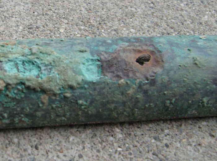

    You may want to read the other threads on copper lines developing holes under concrete.
    Copper and concrete are not a real good mix.
    http://www.terrylove.com/forums/show...ab-leak-repair
    Jun 2009
    Penticton, BC
    810
    I NEVER like burying copper lines in concrete if I can avoid it simply because if you do have a problem with one of the lines then it becomes a big problem. Instead of busting open your ceiling and fixing a leak you're tearing out your floor and jack hammering up the concrete hoping you can find where the leak is coming from.... not a good scenerio.
